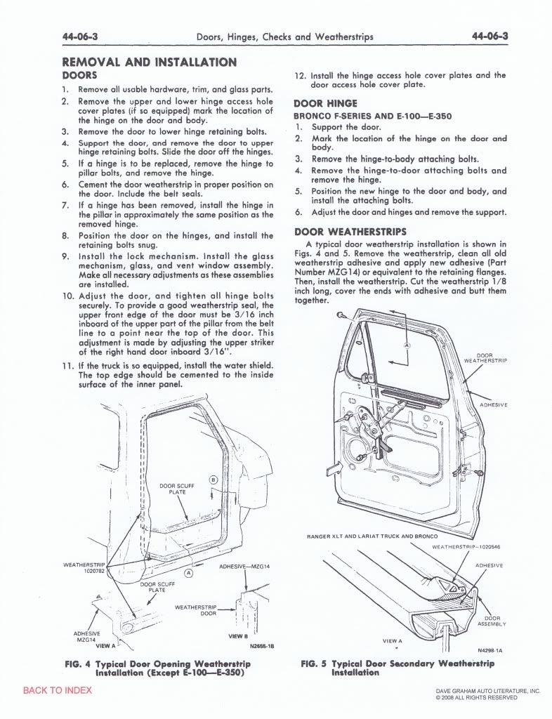

I am currently replacing all of the door seals on my 77 super cab...I want to add the upper seal on the to of the door that came on the 78/79. What I need is a picture of where they stop and start along with what surface it glues to. I have looked everywhere with no luck...the suppliers pictures don't show it either. I'm wondering if someone who has these on there truck could snap a pic for me. Thanks, jason.

look up LMC Truck and or NPD. The strip for 78-70 has a slant the ones for the 77 does not. Shouldnt have to put 78 ones on. I replaced all my seals with new and dont have any leaks.

From the factory service manual:

Leaks aren't the issue...I want to add the upper seal to cut back on wind noise. Thanks for the pic.
