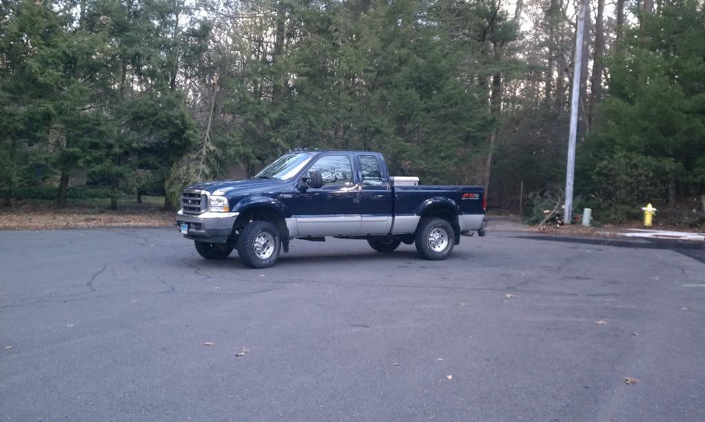

Then yes, either you could buy new coils or coil spacers. Really not that familiar with the coil sprung super dutys but i know both options exist. For the back i put in tapered Readylift 4" blocks because of my short wheelbase, but i believe with your crew cab wheelbase you can buy the non-tapered ones. Lifted my truck about 2" on the dot
before:
after:
