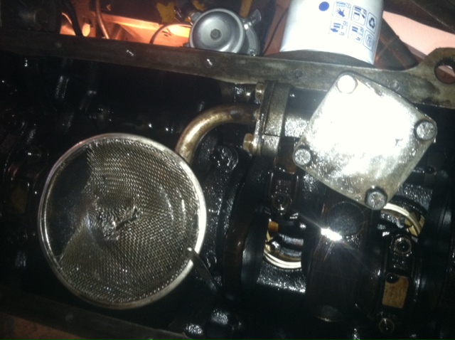

pic of pick up currently on there
I'm guessing that's the car model and i just need to get a truck model.
is this the correct pick up?
Ford Pickup Truck Oil Pump Pickup Tube, Screen Assembly & Retainer - MAC's Antique Auto Parts
Old Dec 15, 2011 | 10:52 AM
52runner's Avatar
52runner
Joined: Apr 2011
Posts: 116
From: Napa Valley CA
old pan
new oil pan
and the pickup

First oil pan looks like a 223 and later. The other oil pan is from a 215.
I don't believe that cars with 215 or 223 had a front sump oil pan. I further believe that all 215 and 223 were similar except for the different mounting locations for truck vs car.

First thing; are you sure your engine is a 215 and not a 223?
If your new pan is a Truck pan, then all you need to complete the transformation is a Truck oil pickup. There's a chance the new pickup has a mount on one of the bearing caps that would require a different bolt on that cap, I couldn't say tho.

Yeah it is a 223. That 215 pan will bolt up, should i not use it? Also heres a picture of the oil pickup i got from AutoZone it wont work but i could modify it with some cutting and welding. the flange is the wrong way and the bends are not right. Should i modifiy this one or take it back and keep looking for the right one?
Old Dec 15, 2011 | 05:10 PM
ALBUQ F-1's Avatar
ALBUQ F-1
Joined: Jul 2004
Posts: 27,303
Likes: 1,062
From: NM
Just buy the right part.
