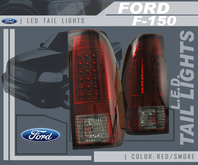

I am researching getting a new set of tail light for my 05' F250 because one of them is cracked. I am getting conflicting reports on what will fit my truck. Is it correct that late 90s to early 2000's F150 tail lights are the same as the mid 2000 F250? I found a set of LED tail lights for an F150 that I like.
I also really like the smoked version, but I think I want to stick closer to the "stock" look
I really like the look of these, they seem so much more modern looking and I think they will really liven up the back end.

97-04 F150 taillights are the same as 99-07(?) f250/350 taillights, also tailgates are the same. I'm currently running a 98 f150 tailgate (still has f150 badges, confuses people) and about to put the taillights in my 01 F250

1999-2007 Superduty Same Design
2008-2012 Superduty New Design, compatible
1997-2003 (and 2004 heritage edition) F150 compatible. (Same design as 99-2007 SD).
Tailgates:
1999-2004 Superduty Same Design
2005-2007 Superduty Same design, new badges
