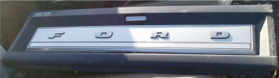

drug this tailgate from out back and can't remember what year of truck it came off of,anyone know what year? thanks

Anywhere from 1980-1984.
Most have a black stripe on the bottom section of the tailgate panel, it appears that yours just has the thin black lines that go around the sections.

Yep.
That is a tailgate from a 1980 - 1984 truck, although it will fit the 1985 - 1986 models also. The difference is the tailgate aluminum insert. The style on your tailgate was used from 1980 - 1984, while the 1985 - 1986 used a larger aluminum insert.

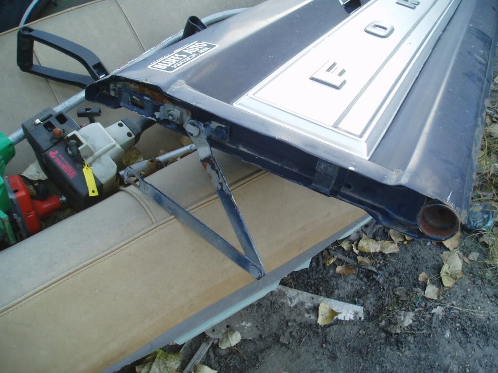

What does the tailgate support hardware look like? That would further narrow down the year it came off of.

here's a pic of hardware

The metal tailgate supports on the side denote a 1980-1982 if I recall correctly.
As for that tailgate panel, the lack of the black stripe on the bottom would mean it is from an XLT truck, as the Lariat should have a black strip across the bottom. Now, the original black strips are easy to peel off with age, so it may have had the black strip before, so it's impossible to really tell what trim package it belongs to.

Tailgate is definately from a 1980-1982.
Part Number: E0TZ-9940700-A: Fits 1980-1982 with metal support arms.
The Tailgate Trim panel will fit 1980-1981 Ranger XLT, Ranger Lariat, or 1982-1984 XLT or XLT Lariat. (The black insert is missing)
Part Number: E0TZ-99425A34-A for the panel.
Part Number: E0TZ-9940282-A : XLT Tailgate Nameplate
Part Number: E0TZ-9940282-B : Lariat Tailgate Nameplate
