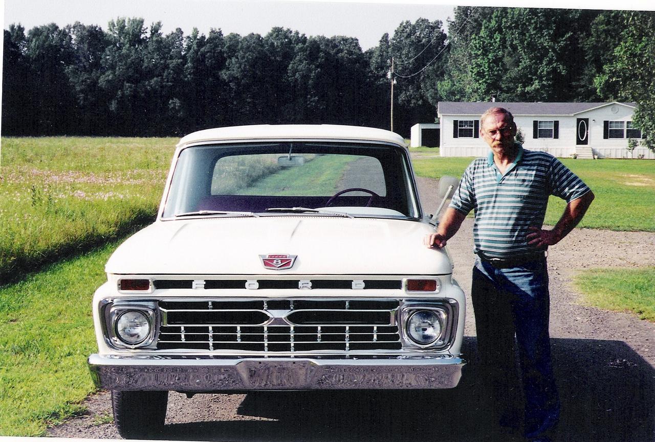

From: Vilonia Arkansas
Name:  dad and 66 cc.jpg
The top picture is a 1966 the bottom is a 1964

Originally Posted by 1996pwrstrk
Attachment 40925
Dave,
From the pictures, it appears you take better care of your '66 than your '64!
