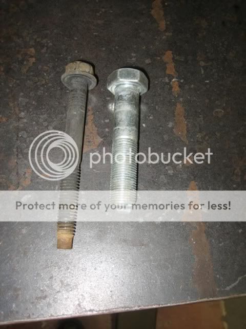

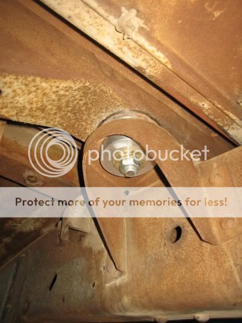

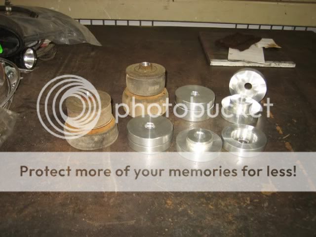

I "body dropped" my '74 supercab and while I was hoping for a 1-2" drop I could only get 3/8" of a drop out of it when said and done. I will be doing a solid mounted roll cage in the truck and wanted to dump the soft, cracked and generally worked over body bushings. While my truck is "lifted" I want the C of G as low as possible so I tried to lower the body on the frame as low as I could. Due to the cab floor clearances over the frame I was only able to cut 3/8 - maybe 1/2" of height. I'll put some pics below of my new body "bushings" that I turned out of aluminum.
Pics:
Stock vs. my pieces. The looks are a bit deceiving here and you won't get as much drop as this pics makes it look like you will as the rubber body bushings compress with the weight of the body on them, whereas the aluminum ones won't.
old setup
new
And just for fun - bolt dia. difference stock to new.
