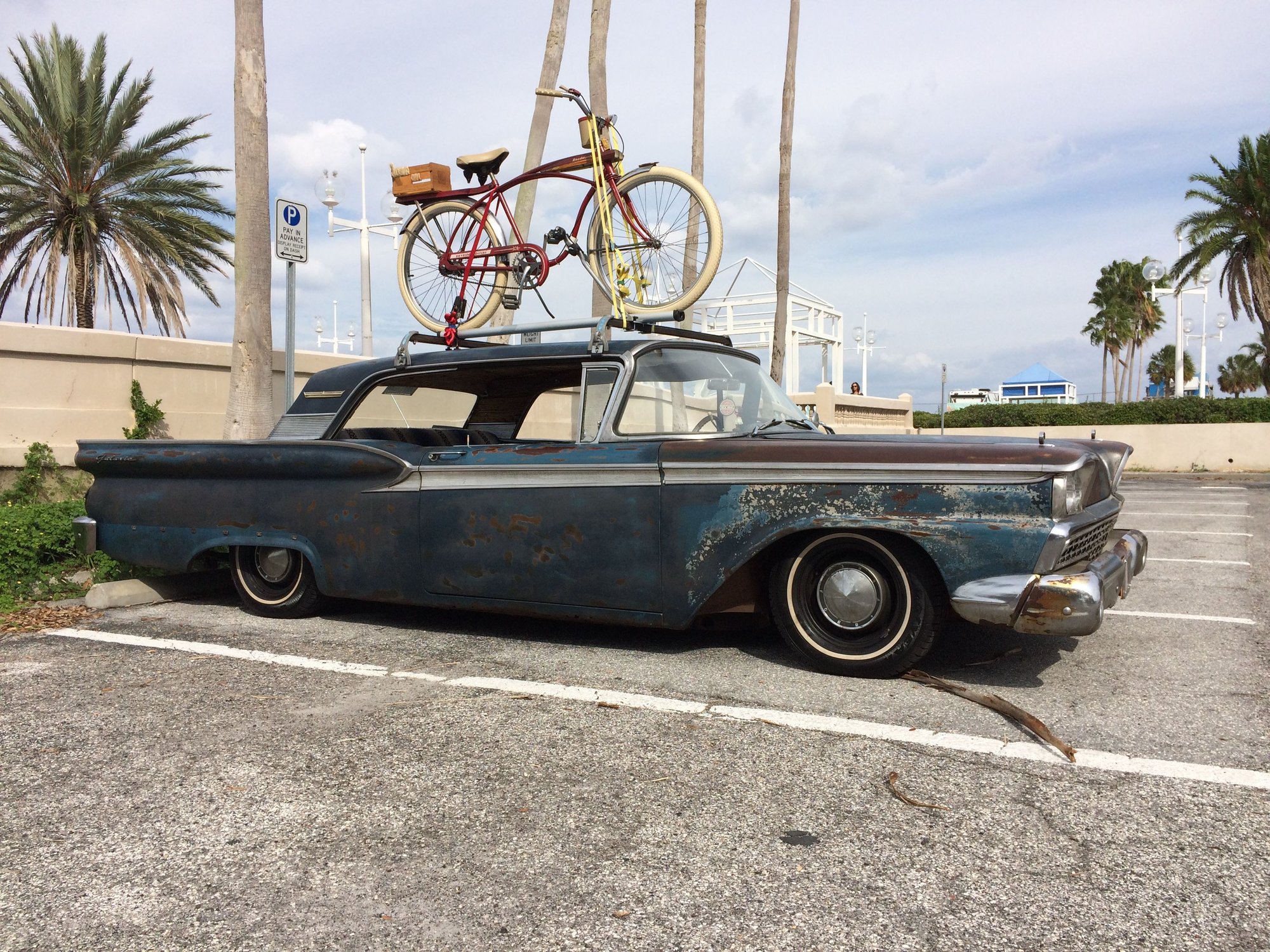

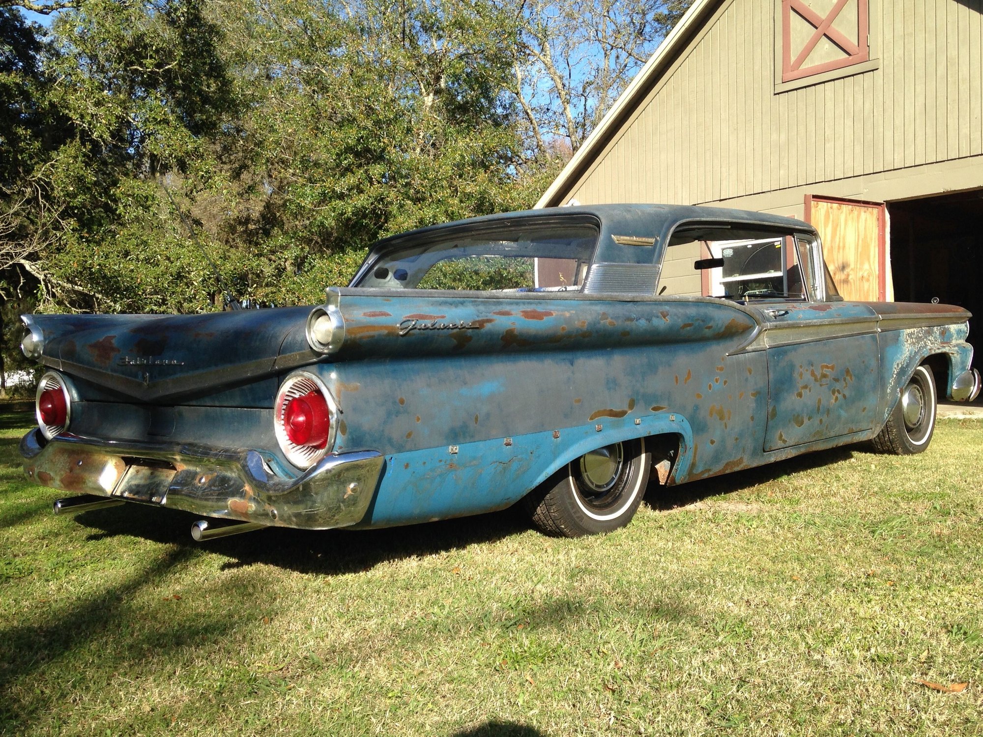

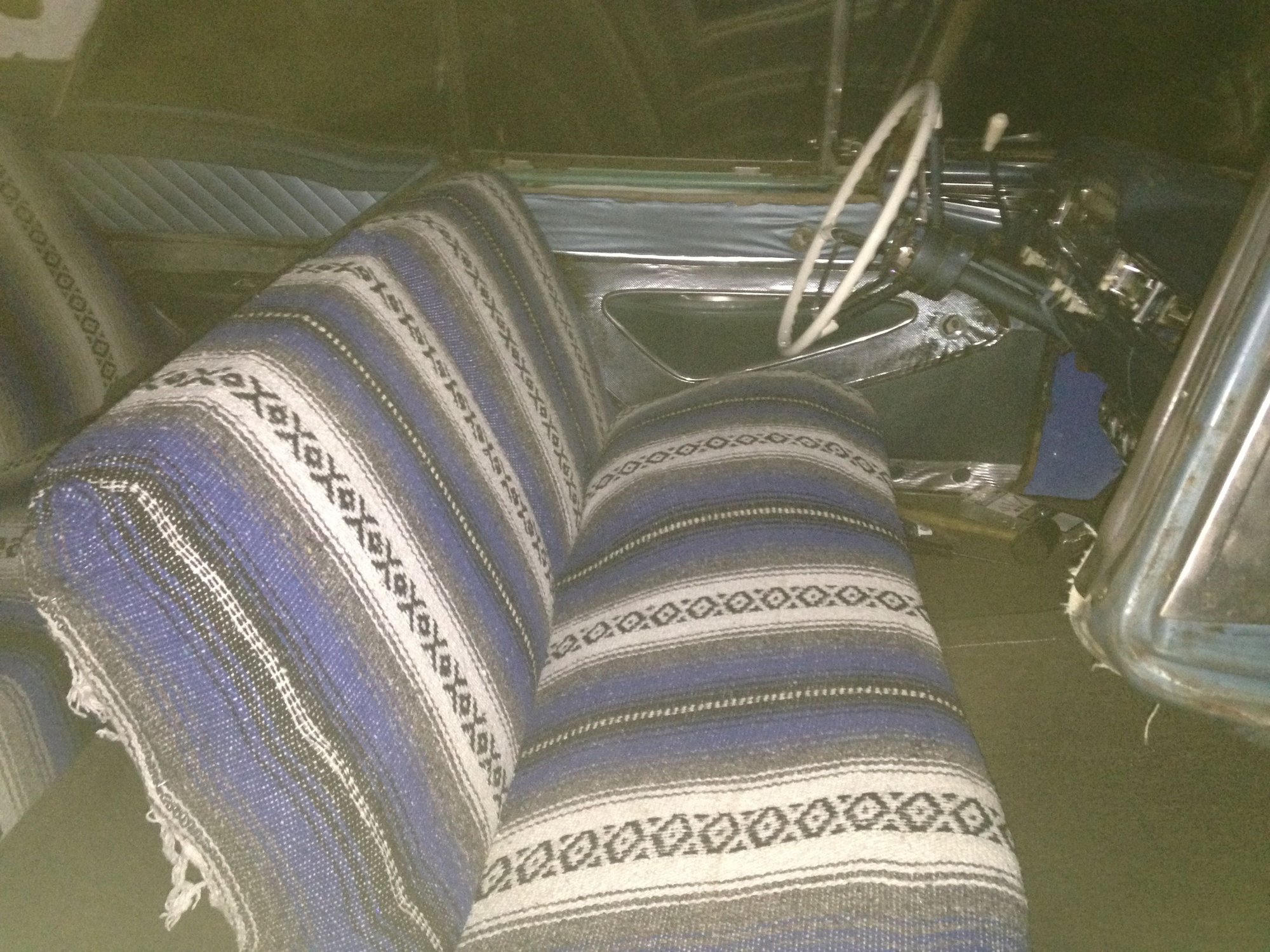

I'll keep this short, spare you my life's story (though there's lot to tell) and let the pictures speak for themselves. StopGap has been up and running for about four years now. She is 100% reliable and has become viable transportation. I was using her as a daily for a while but there are too many crazy drivers in Tampa and she's been retired to a weekend warrior. Of course there are still a few things I'd like to do to her, disc bake swap, a few more interior upgrades and a rebuild of the steering, she has been serving well as is. I don't have the time to be as active as I once was on here but more updates and details of the build will come. As for now enjoy!

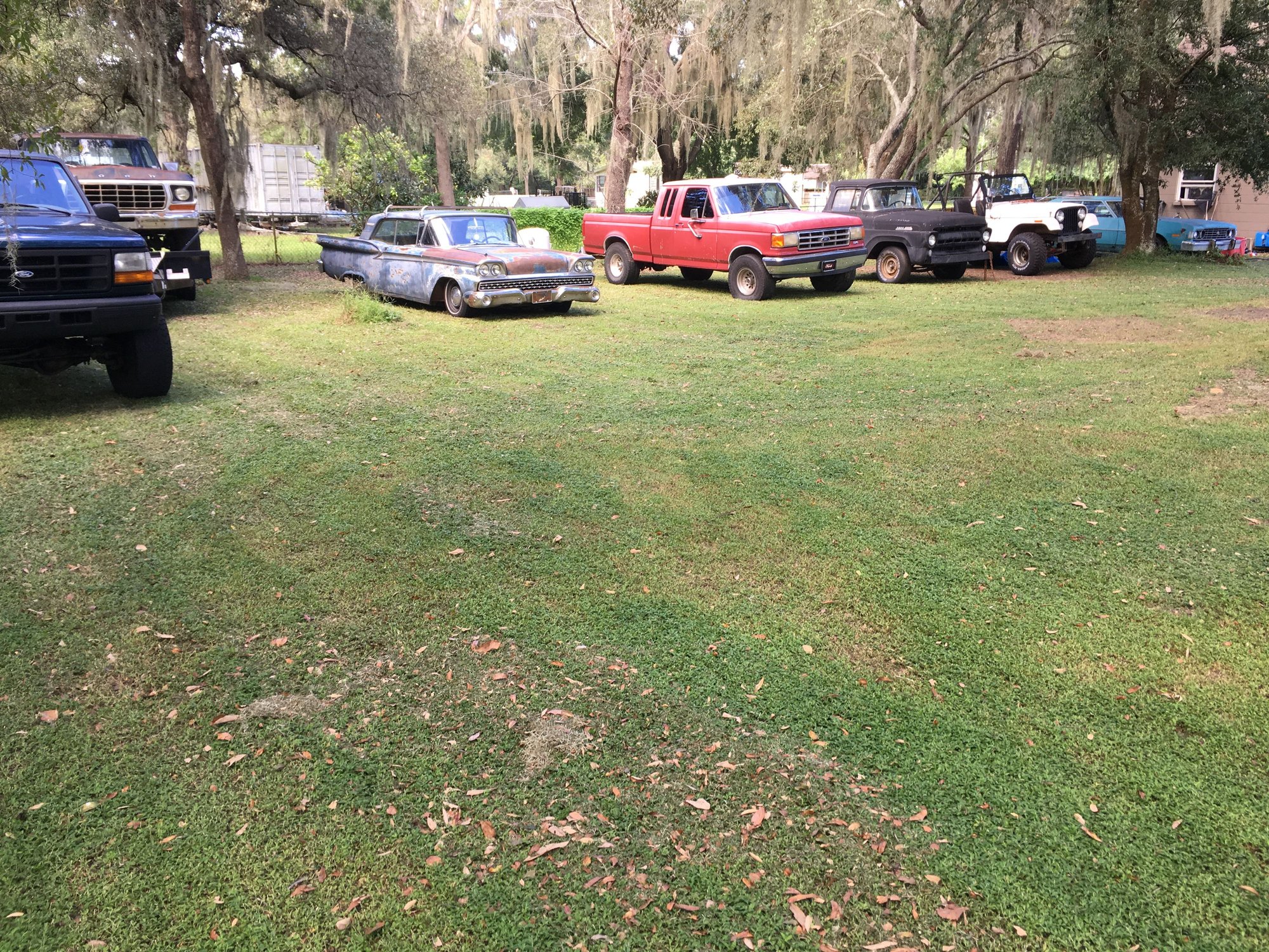

A little peek at my current projects.
From left to right
97 F350--now a light lift and wearing 37s. Still the best truck I've ever owned and is my go to for most road trips and all towing duties
78 F150--just finished a frame repair and is currently my daily.
88 F150--bought to flip, the 351 had a spun bearing. I had a bad case of project creep with a new engine and couldn't install such a nice mill in it. At this time I lost interest and don't know what it's future will be (maybe low buck 460 swap?)
57 F100--this one will be a fairly easy gasser build one day. I have a hot 390 planned and many parts waiting for their time
74 CJ5--the only non-Ford allowed in the yard are Jeep. This one is V8 power, locked on both ends and is MOAB proven. The price was right but will need a completely new tub before driving
73 Torino 4dr--hopes of making this one a daily hasn't exactly worked out. The Cleveland doesn't have pressure on two cylinders and the floor pans need replacing. This one may get the Windsor I built for the 88 while I rebuild the original mill with a set of 4v heads and a goal of a streetable 500 horses
Not pictured is my 78 Mustang II that's just out of frame. Still fighting cooling problems and have it tore down for a new front dress and larger radiator. I have gathered most of the parts for a 5 speed swap but here is one piece that still alludes me.
