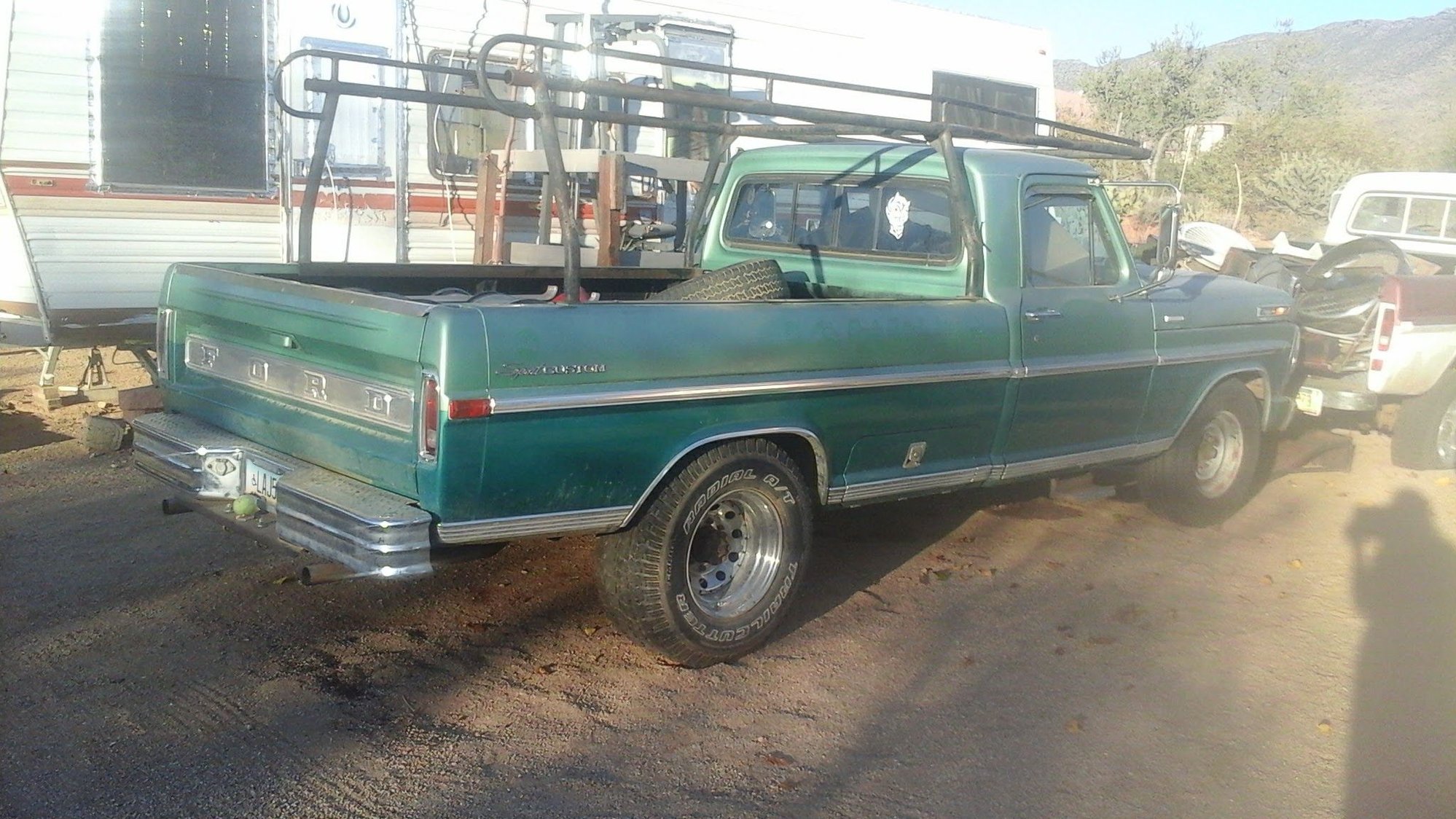

Then what makes my 72 f250 camper special a camper
Picture of the camperspecial emblem
My vin number is f25hrm60707 the certification sticker matches the vin number .marti says it is a camper special. It is also a sport custom. Is sport custom a trim package .does the picture that I posted help .thankyou .or is my 72 cs not a cs .

NumberDummy's Avatar
NumberDummy
Ford Parts Specialist
Posts: 88,826
Likes: 783
From: Simi Valley, CA
Originally Posted by lrd56
My VIN is F25HRM60707 the Certification Label matches the VIN .. Marti says it is a Camper Special, it is also a Sport Custom.
Is Sport Custom a trim package?
No.
F25 = F250 2WD // H = 390 2V // R = San Jose CA Assembly Plant // M60707 = 1972.
I told you this before and as you can see, the VIN does not decode to a Camper Special or Sport Custom.
Since Marti has all the original 1967/79 FoMoCo records, he has this info because it's on the build sheets.
Sport Custom is a model, it was more expensive than a Custom, cheaper than a Ranger.
1970/72 F100/350: Custom, Sport Custom, Ranger, Ranger XLT // There was also an Explorer package available for Custom/Sport Custom.
