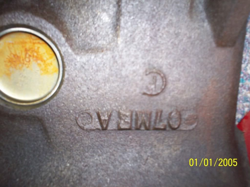

Well, ive never looked on a 460 to see what its stamp consists of but i know on FE motors, there is a stamp on the block on the passenger side ahead of the starter. The C at the beginning is for 60s so the one in the pic would be 1967 when that block was cast, D would be 70s.
Maybe you can see something under if you look around. Hope that helps.
