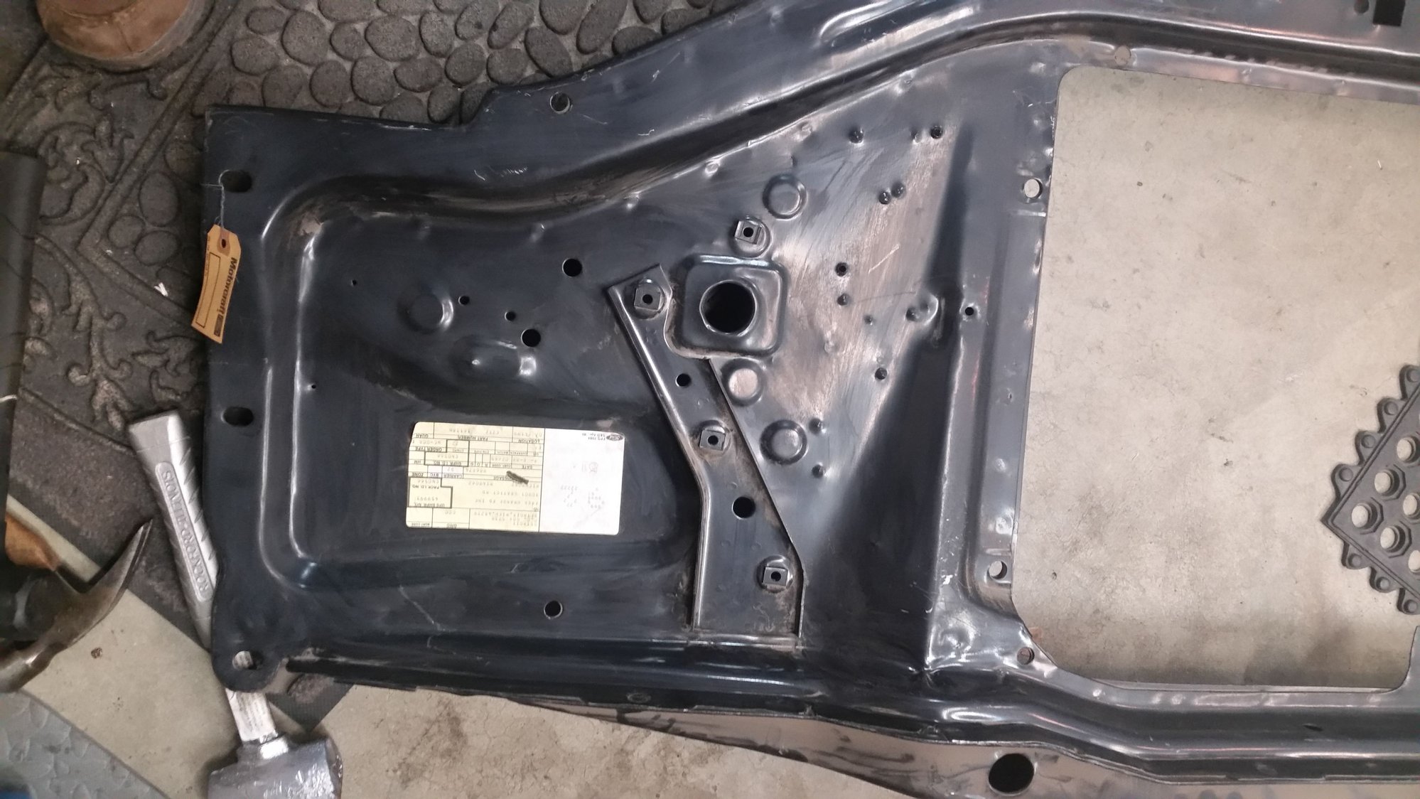

Check this out, I'm pretty sure I just found the core support for the F-500 / F-750. If you are still working on your grandfathers truck and need the support let me know. I'm going to see if the dealership will allow me to return the part on Monday but if you are interested it might help you. I'mm working on my grandfathers 1972 F-250 4x4 so I get it... Cool stuff. My grandmother is still with us so she has been able to see the truck and progress.

Are you sure this radiator support is for a 1967/72 F500/750?
C7TZ-16138-C (replaced by D1TZ-16138-A) = 1967/72 F500/750.
No Ford dealer or obsolete parts vendor has any.
C7TZ-16138-B = 1967/72 F100/250 4WD & F350 w/Super Cooling radiator.
FRED GRANDE FORD in Richmond MI has 1 = 586-727-3415.
C7TZ-16138-A = 1967/72 F100/250 2WD/4WD & F350 with standard/xtra cooling & A/C radiators.
NOS PARTS SOURCE in Olathe KS has 1 = 913-220-5746.

I bought the 1 from those guys at Fred Grande Ford 2 days ago. It is not correct. Looking at my huge vol manual, I looked up all the ford trucks to see if one of those matched... the F500 F750 and in the pics it looks correct. I'll post pics. But very interested in what you think.
Old Mar 4, 2017 | 01:22 PM
F2501972's Avatar
F2501972
Joined: May 2014
Posts: 617
I will post one more pic of manual page. I wish I was wrong but the sticker says I bought the correct part but the bolt pattern says i did not. It's close but will not work on my f-250 4x4.
