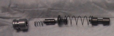

There is a line pressure modulator valve in the accumulator valve body that has a piston in it that increases spring pressure applied to the line pressure regulator via pilot pressure from the electronic pressure control (EPC) solenoid.
The 3 pieces on the left of the picture make up the line pressure modulator (the small spring is part of a reprogramming kit). The spring and valve at the right make up the line pressure regulator.
Attachment 37497
Now that makes sense to me.
I would still think that the change would be most impacted if the valve body was changed... I would think manipulating the time the solenoid is open/shut would still be limited by the stock valve body.
Thanks for the info!
