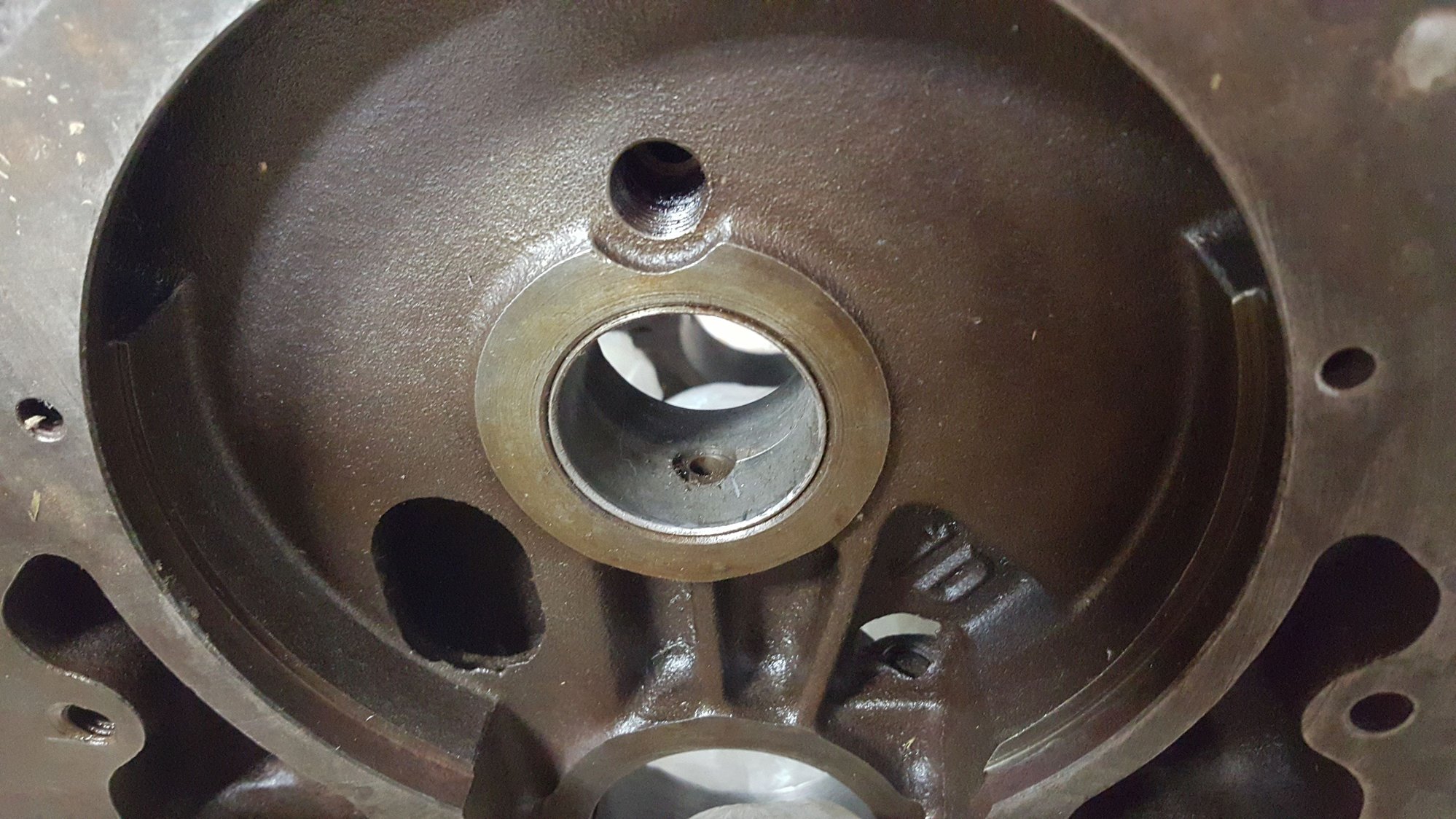

how do you id a flathead ?

Hope this will help. I'm trying to figure this out for my own knowledge and for ordering parts.

Generically, it's an 8BA block, used from 48-53 in trucks, 49-53 in cars. It appears to have been "relieved", i.e., the part of the deck between the cylinders and the valves has been ground down to improve flow. Do you have any history on the engine? It is exceptionally clean, appears someone spent some time grinding the deck water holes smooth.
Have you had it checked for cracks?
If you got valves and springs with it, a picture of a set would further define the specific years.
PS -- are those pennies in the center holes on the intake deck?

I just got this block along with a large list of other parts in a trade. I know it's been relieved and that the gentlemen I got it from said it is free of cracks. I'm about to take it to a machine shop and just wanted to knowledge myself more on it. So what's your opinion of it? Is this a good block? Would it be worth my money building it up. I have triple deuces and offenhouser heads, intake. Mallory crab dist. I sky 3/4 cam. Etc. All this stuff was in the trade. What are your thoughts?

If you are just going to build it to sell it, I think you're taking a big risk. You'd likely make more selling it as a "guaranteed" crack-free block with the rest of the major components. Sell the 3x2 manifold, heads, and other goodies separately or as a package deal. The crab distributor won't work on this block without some adapters and aren't popular anyway.
Ebay is full of $5k -7k built flatheads. Unless it is built by a known builder and dyno-tested, I don't think there is a huge market for them that way.

I'm building this for my 1950 ford f1. This is for me and my truck lol. I have the timing cover that goes with the block that supports the dist. And the isky cam also is for that dist. So this stuff won't work with this block?

Not knowing how familiar you are with flatheads, I'd say "yes" you can run the crab, "but...". You have to run the correct timing cover, cam, cam drive setup, and a few other tidbits to make it work. The 59-series cams put thrust in the opposite direction. Are the Offy heads 8BA style or 59-style (center outlet)?

Front outlet. 24 stud Offy heads
