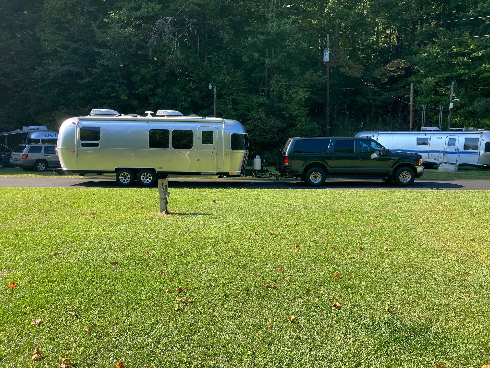

Yes. In get both. I have a 2000 RWD and have B codes from ATS and the RAS. I also have AirLift bags, but that’s another story. I wanted something equivalent to an F-350 suspension and Junior at ATS suggested that since I already had the RAS, to just swap out the rear springs for their B springs. You should have in the back of your mind that a similarly outfitted 2000 F-350 was app. 1,540 lbs. lighter than, at least what my Ex. And the fact that the original springs were rated somewhere BETWEEN the F-150 and F-250. My rear end is on the high side at rest, but it comes out just about even when loaded down. Guys at the Airstream dealership were surprised that the rear end just dropped an inch when hooked up.
We tow and look like this going down the road:
