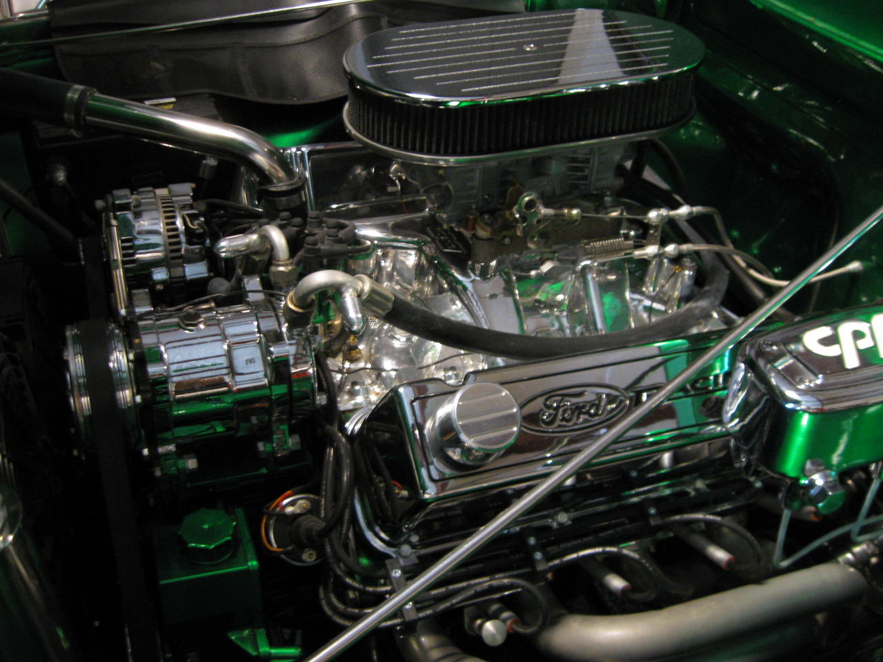

Sam is that an enduroshine Edelbrock intake ?? I didn't think they made one for a 460... or did you spend a week buffing...
I ordered a standard Performer today... wish I could have found the shiny stuff..
and I love the ball milled covers.... where did you find the pretty stuff ??? all I see is the same old same old that everyone else has

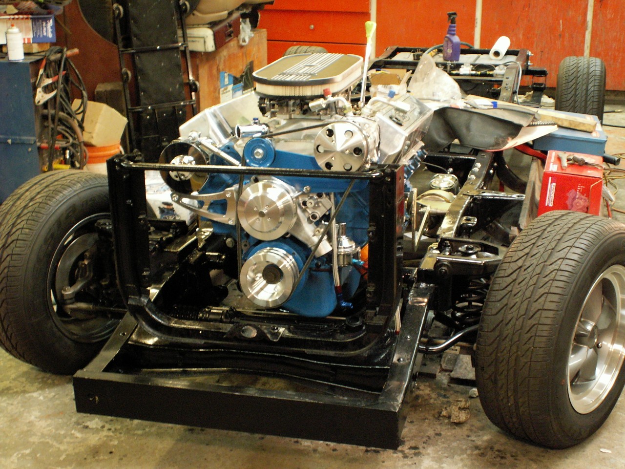

I bought it for $200 in 2007.
I'll send u my ball milled covers.., they used to be made by Procomp. I pulled them off for the chrome Ford Racing covers.. the polished covers just weren't competitive with all the chrome in the chevy based engine bays. But I did them cause they were different originally.
I replaced all the polished stuff with chromed.. master, valve covers, and a/c compressor, carb cleaner top. already had chromed alternator.
before and after below
