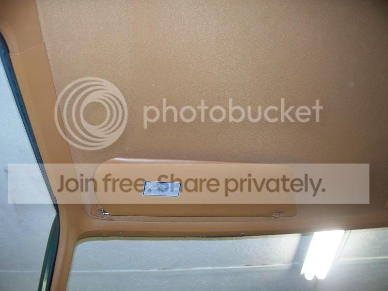

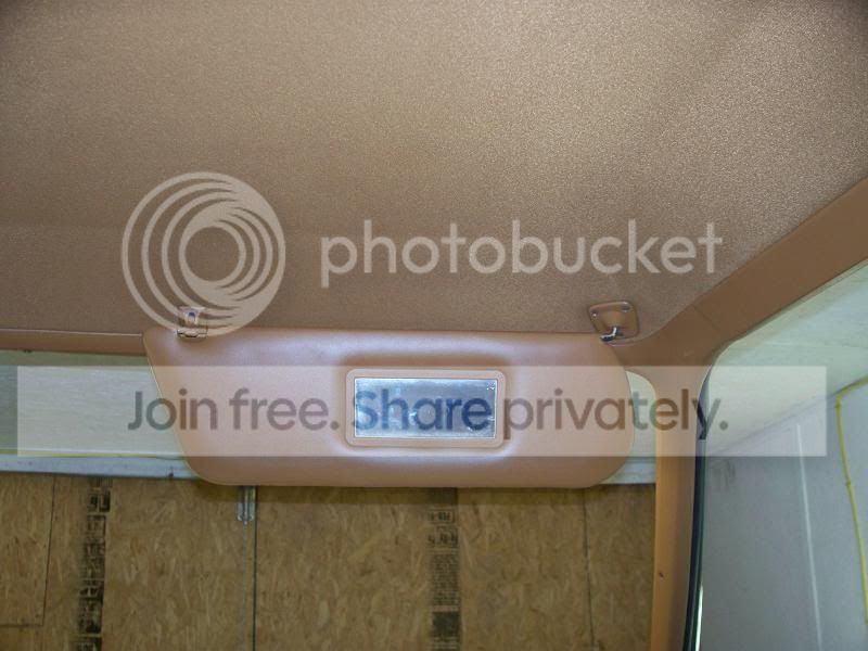

I used SEM on mine. I also pulled used a vinyl pair instead of fabric. If you follow the directions and use the SEM adhesion promoter, they seem to hold up fine. Below is a couple pics of mine. The visors were originally a tan color and I changed them to Caramel.

Those look good, thunderguns71! Did you just use the screws that came with the center clip, to screw into the roof? Is it really that simple?
Old May 13, 2011 | 05:23 PM
thunderguns71's Avatar
thunderguns71
Joined: Feb 2004
Posts: 739
Likes: 11
From: Westfield, North Carolina
It's pretty simple. Once I decided where I wanted to put the center clips, I drilled the holes and used the factory screws. I'm sure a self tapping screw would work as well. Just make sure the head isn't too large for the plastic pieces.

thunderguns71, what is the trick to painting around the mirror on the passenger's side?
Old May 13, 2011 | 06:43 PM
thunderguns71
Joined: Feb 2004
Posts: 739
Likes: 11
Masking tape. Covered the whole mirror in tape. Let it overhang some, then took a razor blade and trimmed the inside edge. Works every time. I also done the same thing with the sticker on the drivers side, just had to be a lot more careful.
