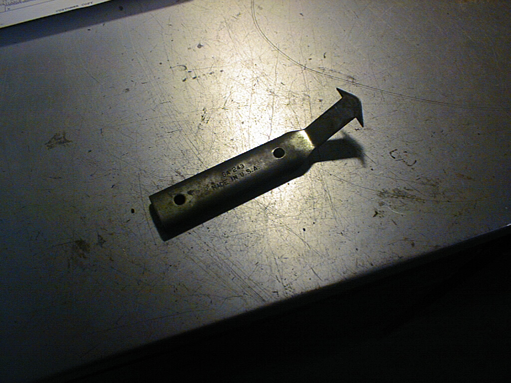

This is the tool you need if you remove the trim
Name:  WS trim tool .jpg
Attachment 36277
Thanks Rick but Ian wrote that I dont need to remove the trim
