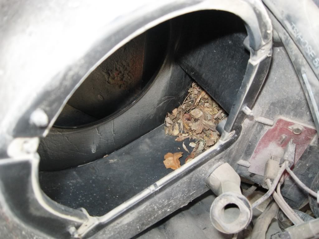

So I pulled the fan and found a nice stash of leaves.
The photo only shows small portion of the pile that was up against the condenser and around the fan switch. It obviously was the cause of all the smoke as it had a burnt odor to it. I vacuumed out the heater box and buttoned it back up. Glad I found out about this problem.
Thanks Ctubutis!
