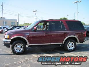

A few months back I got rid of my 05 F250 and picked up a 99 EB Expedition.
I tow my off-road truck on an open car-hauler and just wasn't going as much as i used to and couldn't justify the SD payment and fuel economy anymore.
I enjoy driving the Expedition and all of its creature comforts. It's a pretty nice truck and was rust proofed so there is not one spot of rust anywhere on the body and all the underside it pretty decent too.
I'll post a few pics
Still @ the dealer

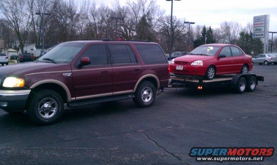

Looks like I'm gonna get a small test earlier than expected. A friend called and needs a tow. Her 02 Kia Rio snapped a T-belt. Hello side job!
It won't be a very good indication of towin ability as it's a small car but might give me a slighltly better idea of how the truck is gonna handle the weight

I was pretty impressed with the truck's towing ability when towing a car. Could use OD but I just left in in 3rd mostly. Had a bit of sway in windy spots but that's to be expected.
Handled the weight just fine with my airbags and WD hitch. no squat at all and I had the car loaded as far forward as I could and still chain it.
May make a more permanent tow rig than I first imagined
