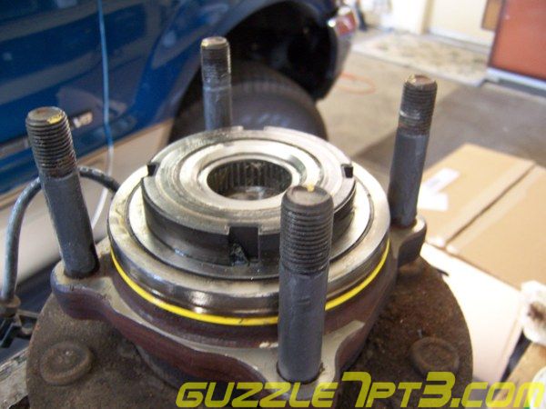

Someone once told me that if the noise goes away when the hubs are locked then it is probably needle bearings. I believe the needle bearings are replacable. Someone correct me if I'm wrong.
If you aren't familiar with the location of the needle bearings I can take a picture this evening when I get home.
EDIT:
Here is a good picture of the needle bearing. From Guzzle's website. Welcome to guzzle's 4x4 Needle Bearing Maintenance Web Page
