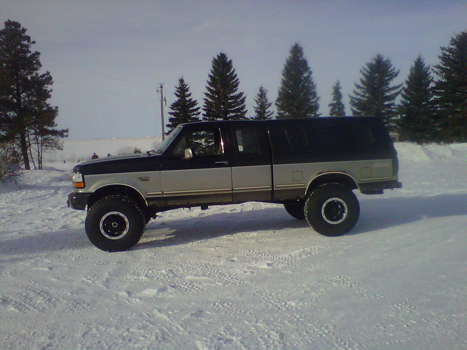

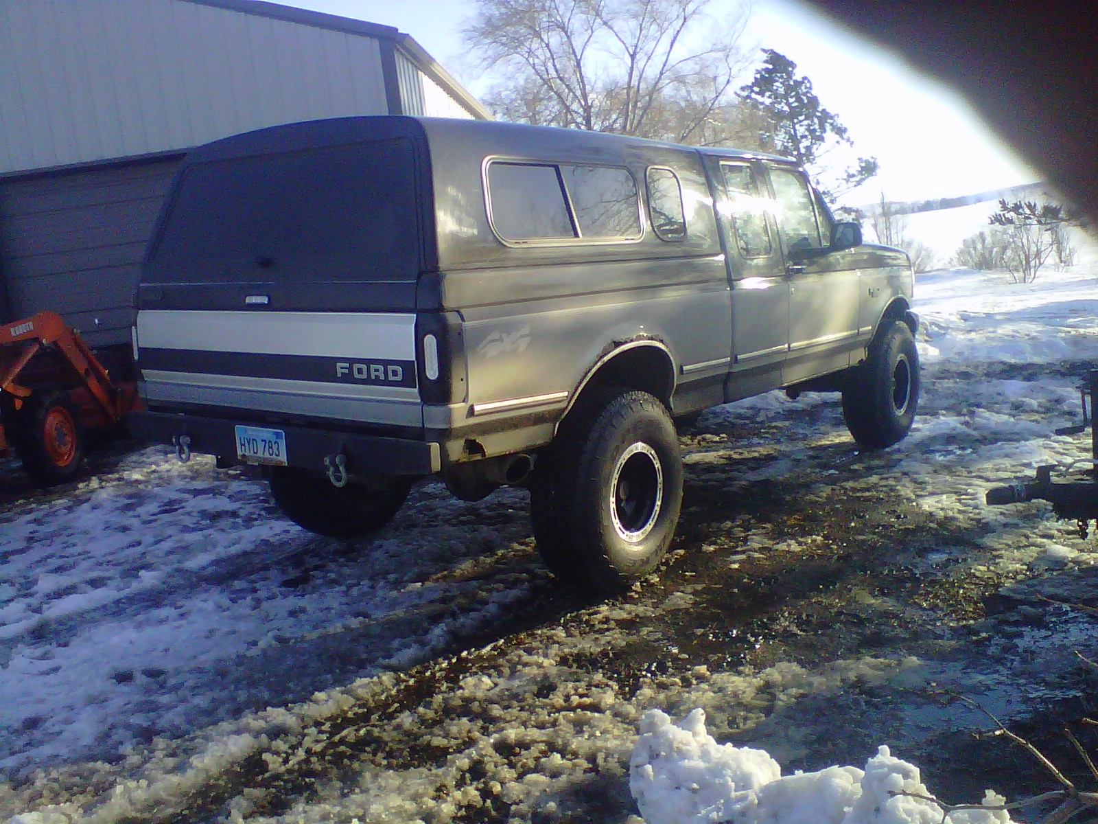

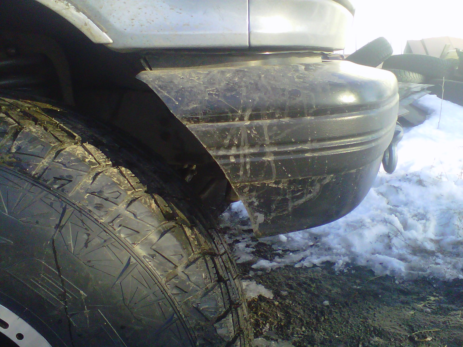

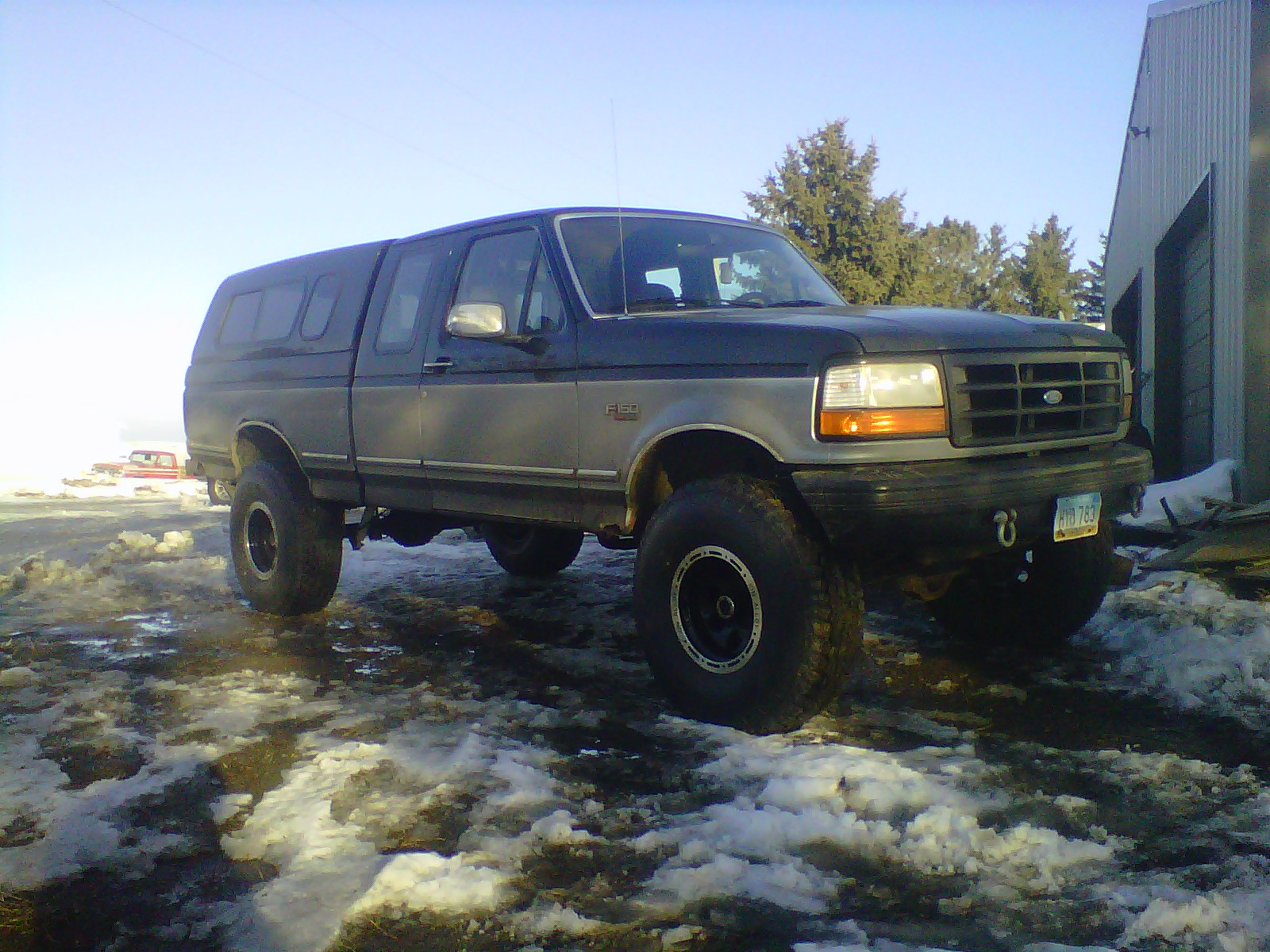

I get almost none with mine(37s on a 5 inch). But when its flexed as far as it will go, they touch the bottom of the radiator support if I turn all the way one direction.... But, I have a trimmed bumper.
Do you have a bigger pic of your truck? Not going to lie, I really dig the look of 35's on a 4inch lift. I'd just be afraid of rubbing issues.

Bumper trim... But I pushed my axle forward 1.5 inches to keep the tire out of the rear of the front fender.
I would say a 35 will clear with a 4 inch lift just fine.
