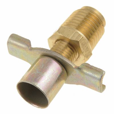

Where did you buy your petcock from? Im getting ready to flush mine and I would to add one to both sides if possible. Can I get them from dieselsite?

Check with local parts stores. Get one like this Name:  radiator drain.jpg
Size:  17.6 KB and you can put a hose on it to reduce mess when draining.

Originally Posted by mueckster
Check with local parts stores. Get one like this Attachment 33429 and you can put a hose on it to reduce mess when draining.
Yep. 1/4" NPT. Same as most air compressor drains (home cheapo has'em by air tools...)

The block is in the way to use same valve on drivers-side. I bought a different valve once, but decided it was EASY to use the existing plug on that side...
