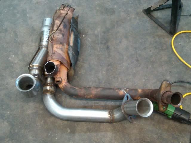

I built my own mandrel y with a few parts from summit....about $80....and good day of fitting and welding. Wow...what a difference. I purchased 2 2.5" u-bends, a magnaflow merge collector and one stick of 4 foot 2.5 pipe. No cats.

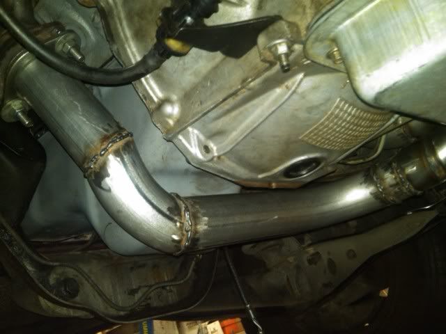

Another pic installed
