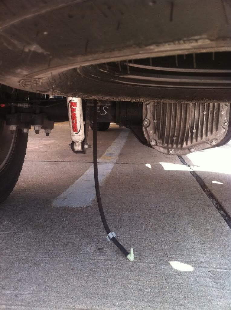

Ok where does this re-attach?
So my security desk calls me today to tell me I have something hanging down from my truck. I didn't crawl completely under there to look but my guess is a breather tube for the rear diff. Does this sound right?
Next question is....where is it suppose to be??? I dont really want to spend time at the dealer while they just hook it back on. Anybody got a pic of where it is suppose to be?
Here is the picture.
http://i1097.photobucket.com/albums/...ts/photo16.jpg
Thanks in advance.

It fits into a clip above the differential. on the frame.

There is a clip still attached to the hose, so I will try to find a spot it will attach to on the frame.

I just clipped it onto something that the clip would fit around that kept the pipe in a vertical position. I think it's hooked onto the bake line bracket on the frame where it goes from hardline to hose...

rear diff breather tube extension....maybe

Yeah thats what i was thinking. Make sure it isnt plugged before you put it back up so you dont blow your seals.
