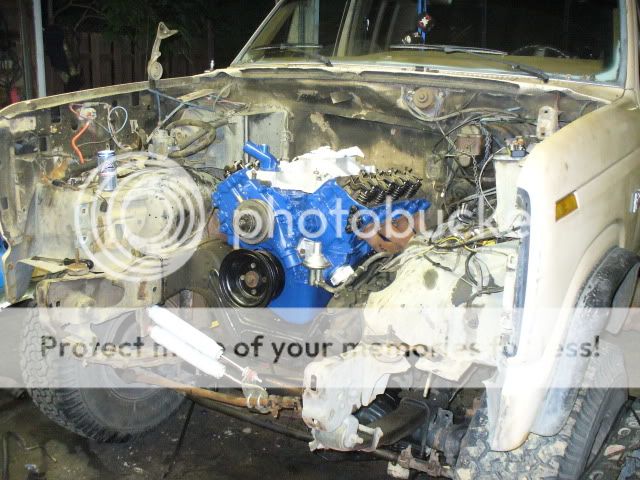

Over 8600 GVW is considered "Heavy Duty" by the EPA. None of them came with cats, Cali or not.
<a href="http://www.flickr.com/photos/24183730@N03/2340584319/" title="IMG_1931 by Jim_Urrata, on Flickr"><img src="http://farm4.static.flickr.com/3128/2340584319_e1d8768007.jpg" width="500" height="375" alt="IMG_1931" /></a>
I have a BW1356 T/C, I didn't see anything cheaper than the Thorley Tri-Y's that said they would fit past my slave cylinder.
Not to doubt you, perhaps you could post some part numbers and applications?
