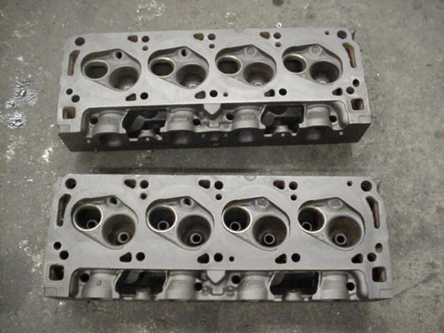

Old Mar 4, 2003 | 10:40 PM
TMI's Avatar
TMI
Joined: Nov 2002
Posts: 1,198
Likes: 9
From: Fairmont
400 brains
Like these?
Old Mar 6, 2003 | 08:59 PM
Matts72's Avatar
Matts72
Joined: Jan 2003
Posts: 10,323
From: Montana Territory
400 brains
Sure are pretty aren't they!
