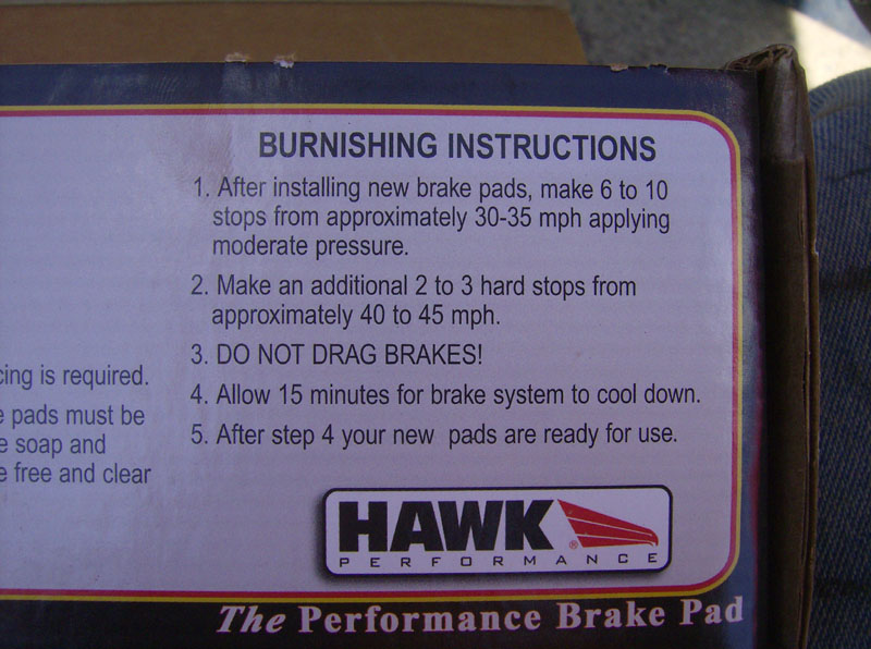

It should have the procedure written on the box.
Here's the procedure from my Hawk LTS box....

Thanks for posting that....i probaly would have not even seen it

Most shops never heard of or never do it either. Thats why a lot of people end up with squealing brakes that don't perform the way they could. Follow the instructions on the box and your good to go.
