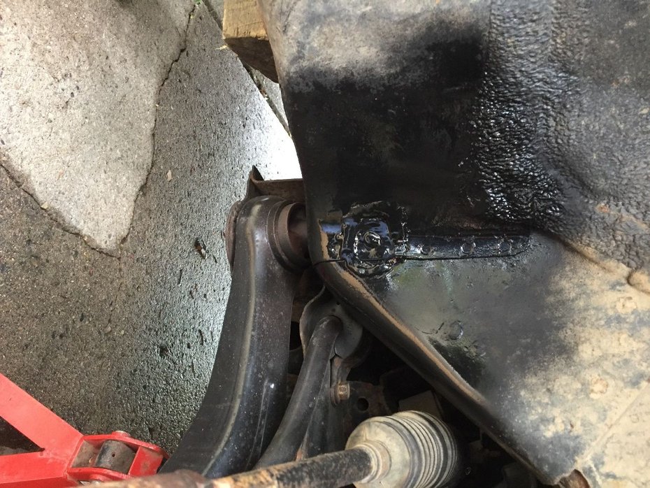

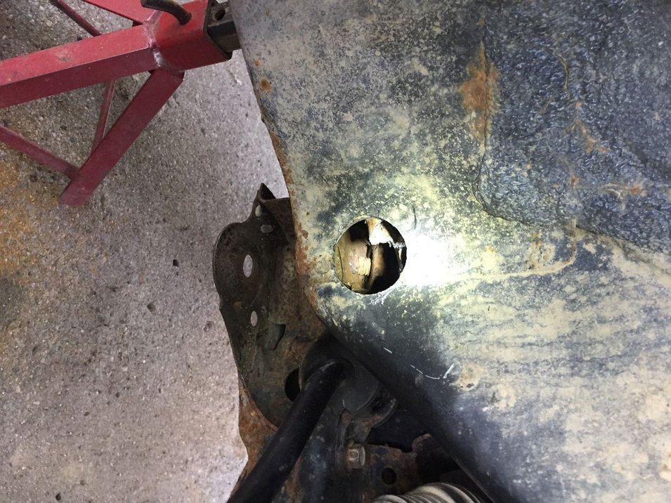

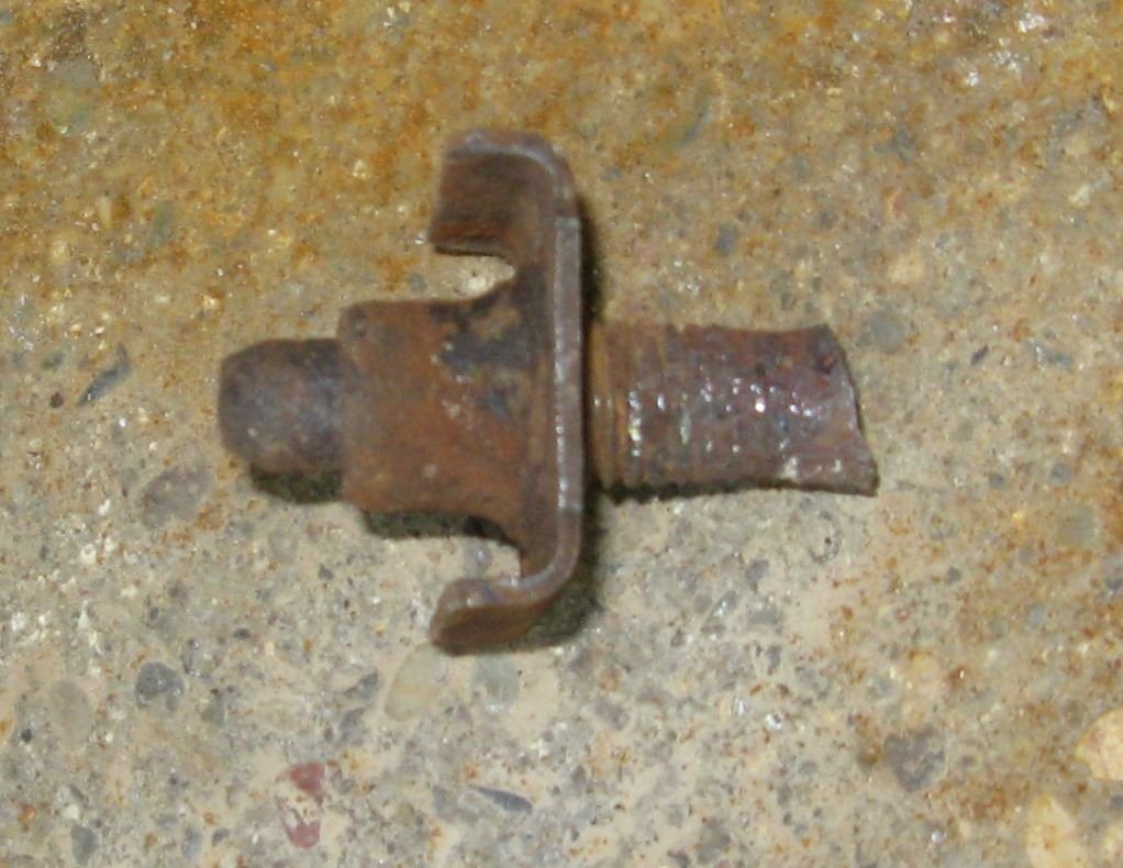

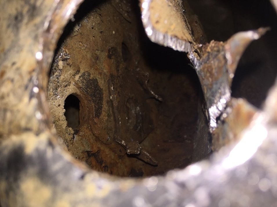

Figured some pictures of what the problem is might help someone else if they are searching for a solution. This is the passenger side rear control arm bolt/nut. In my case the bolt seized to the bushing sleeve so when unscrewing the bolt it stayed stuck in the sleeve and drove the nut up until it bent the retaining ears and let the nut turn freely. I used a grinder with a cut off wheel to cut out the sleeve and bolt. I looked at going through the floor as in the previous post and decided that would be a hassle with no room to work if the bolt or nut had to be cut out. To do again I'd do this hole saw through the side in a heartbeat. The slug that came out was welded back in place.
