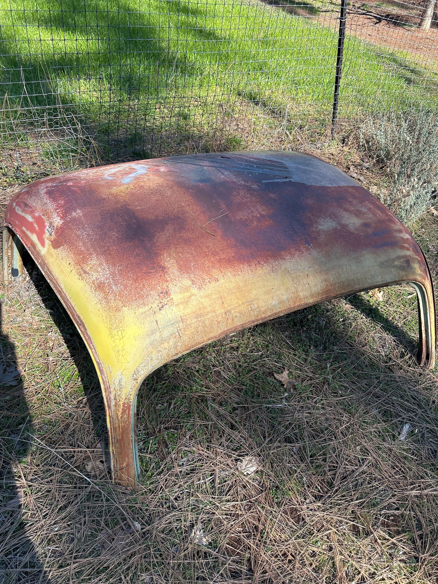

1952 drip rails
Hi Wes, welcome to the forum!
Replacing the drip rails isn't as easy as it sounds. And I find it hard to believe any reputible body shop, with an actual knowledge of how cars and trucks are built, would remove them thinking they'd be "easy" to replace. The drip rail unit is part of a sandwich of panels welded together with the roof skin, inner structure of the cab, and outer body panels. You almost have to disassemble the cab to replace them, and that's if you can cut them out of another cab that you have to disassemble to get them from. It's not a part you'll ever find in reproduction. If you want the drip rails back, you'd be better off finding a good replacement cab and selling the one you have to a custom guy.
1952 drip rails
