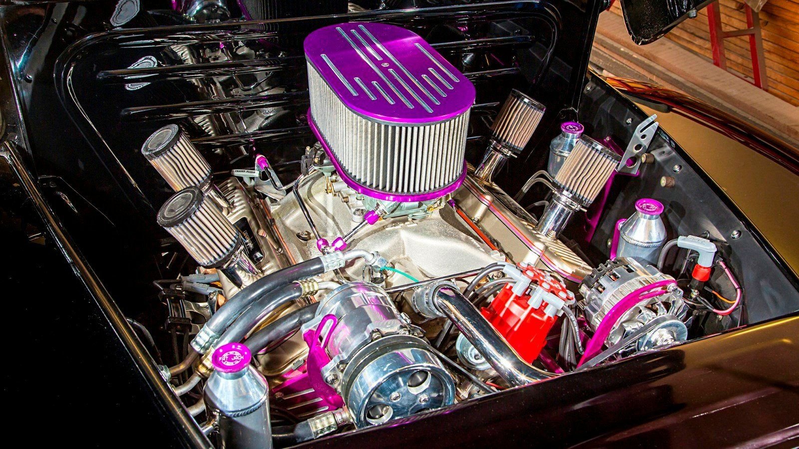

Under the hood
Jack sent a cast-off 430 Buick engine over to Clay Smith Engineering where the machine work was done. They left the stock crank alone but bore the block out to 444 ci. Jack's son, John, also a builder, assembled the engine with a Clay Smith cam, H-beam rods, and JE forged pistons and oil pump. The iron heads run TA Performance stock rockers were ported and massaged and then covered with stock Buick valve covers modified by Jack with breathers. Jack also used a TA Performance aluminum medium-rise manifold and 750 Holley as well as one of Jack's purple anodized billet air cleaners. He added a TA aluminum water pump with additional flow vanes. Buick pulleys were used but not before they were dipped in chrome. The firewall, fender panels, and core support were all fabbed at Fat Jack's.
The radiator is aluminum and the MSD standalone distributor has been painted, polished, and chrome anodized as pictured above in red. The stainless steel exhaust system includes Magnaflow mufflers. A turbo 400 transmission was rebuilt and mated to the Buick engine with an adapter.

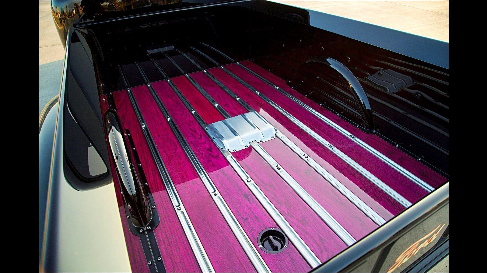

A bed fit for a king
The bed sports inner wheel reliefs with purple tinted wood slats and stainless machined runners made by Jack himself. The reliefs machined into them were done by Mike Curtis at Jack's. Jack and Mike also fabbed the stainless bed strips, filled the stake pockets, made the inner fender reliefs and third member cover. Afterward, Jack dropped a basecoat of clearcoat black and finished it off with Dennis Ricklefs pinstriping and lettering on the tailgate. Ricklefs also added his pinstriping to several undercarriage components including the lower control arms and oil and transmission pans.
