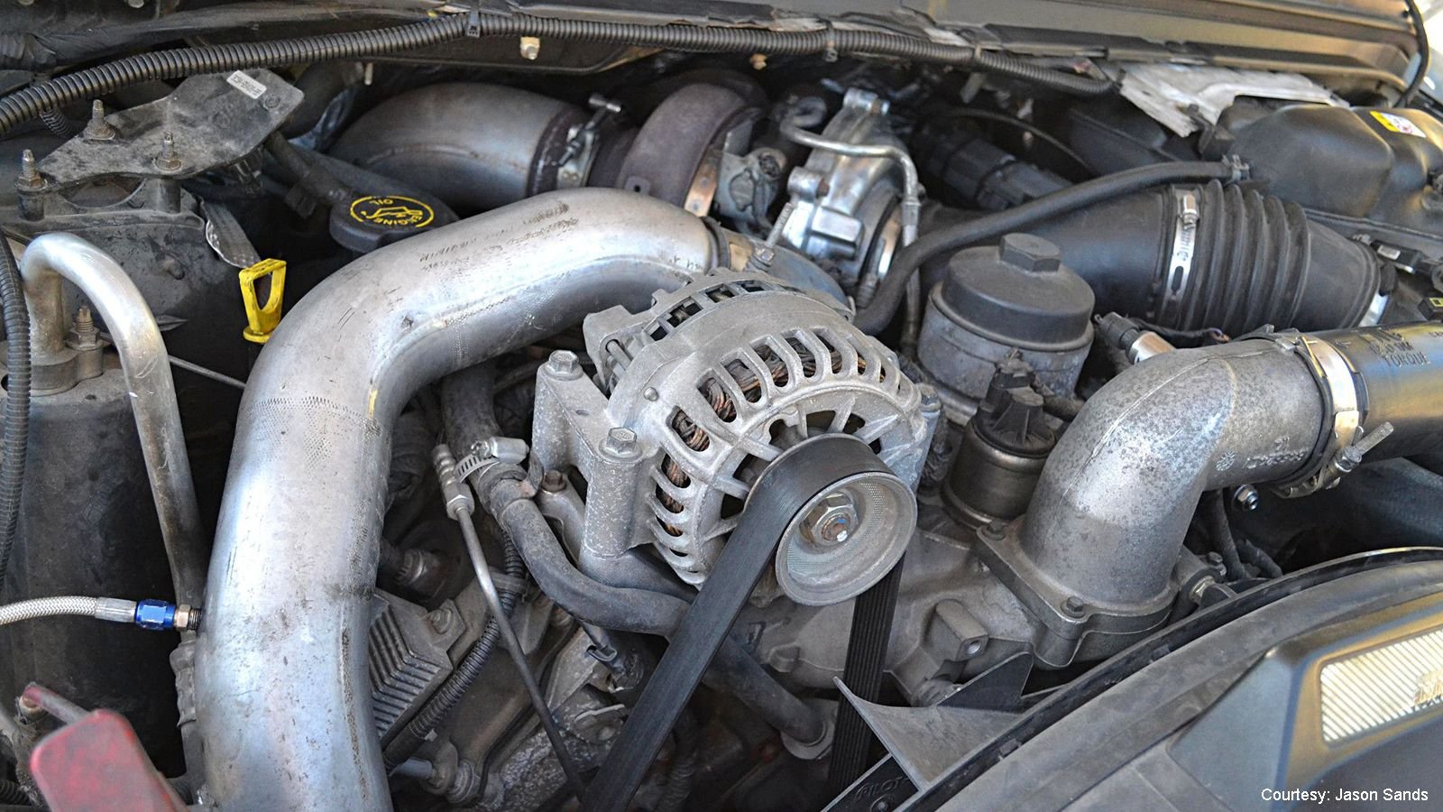

Ross knew where he wanted to spend money and it wasn't on his long block. Though of course, a good seal between the block and heads is vital so Ross installed ARP head studs and a set of performance head gaskets, he left everything else stock, including the block, crank, pistons, rods valves, and springs. Then he turned his attention to boost. To save his factory rods and keep cylinder pressures low Ross figured he'd stick to moderate levels of boost and make up the difference by adding nitrous and not being stingy with the revs. He chose a Barder Turbo Service 71mm Stage 4 turbocharger and plumbed it into the stock intake system. The Stage 4 is a variable-geometry turbo, like the factory unit, and features a 360-degree bearing.

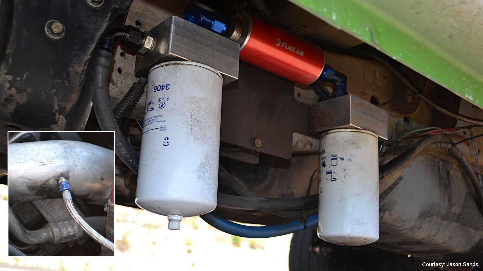

With all the extra air coming in, the next order of business was upgrading the fuel delivery system. Ross went to work swapping his injectors out for Holder’s Diesel Performance 230cc units with 100 percent over nozzles, and installing a regulated return kit from Power Stroke Enginuities. A Thumper II high-pressure oil pump from River City Diesel keeps the turbo spinning smoothly. Ross’ own Flyin’ Diesel Performance shop built a fuel delivery system utilizing a Fuelab lift pump, and dual filters, lines, and filter blocks. The F-250 sports a single stage nitrous system; Ross tweaks the jetting based on elevation and weather conditions on track day.

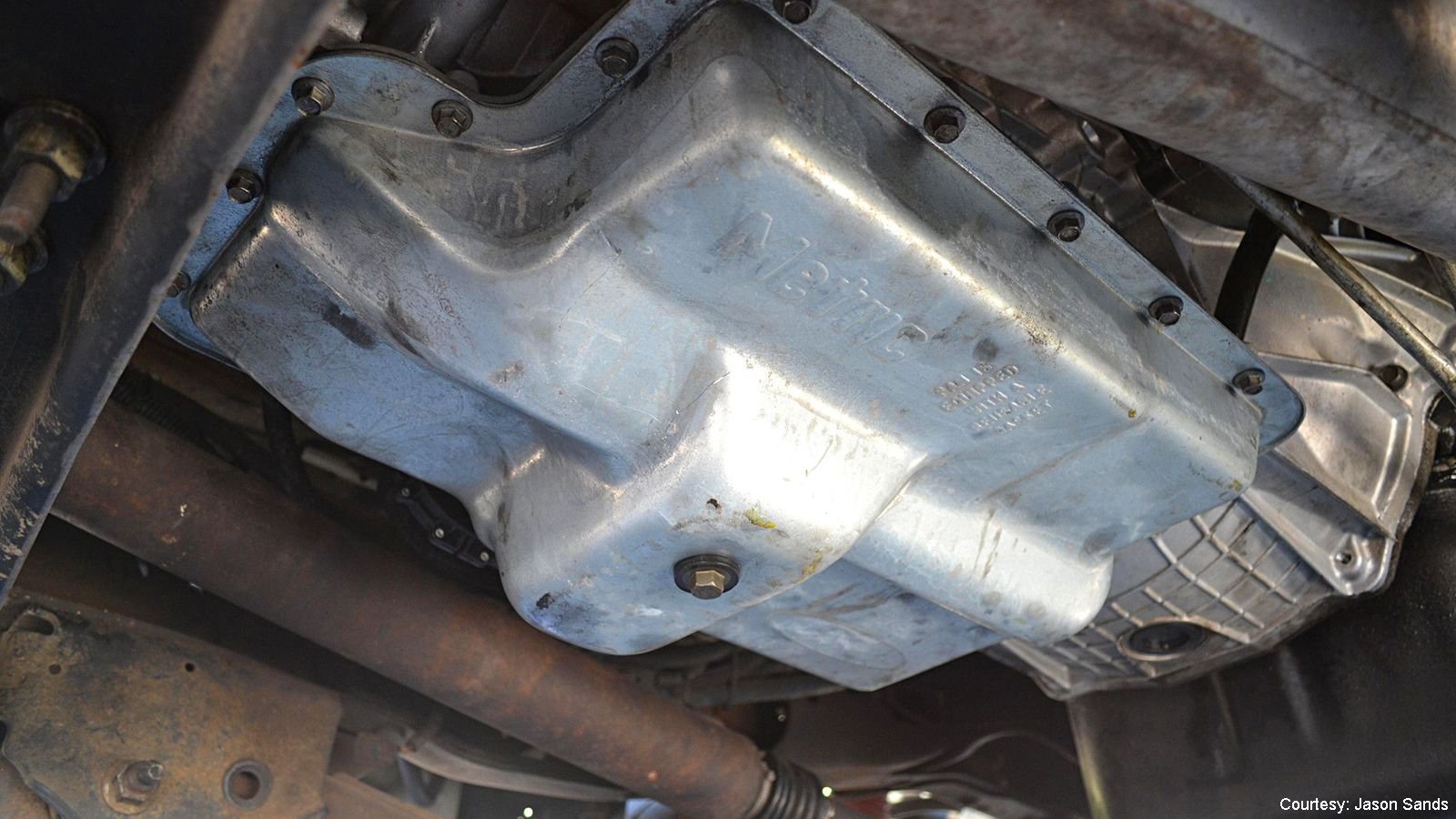

All that money saved on the core engine came in handy when it was time to turn to the transmission. Ross felt losing a gear would cut his E.T.s so out came the original equipment 5R110 five-speed automatic and in went an older 4R100 four-speed. The wealth of parts available for the 4-speed came in handy when Ross rebuilt it using stronger input, intermediate, and output shafts. He also installed Raybestos GPZ clutches, a Precision Industries torque converter, and a TransGo shift kit. Computer control by Powertrain Control Solutions oversees the whole operation.

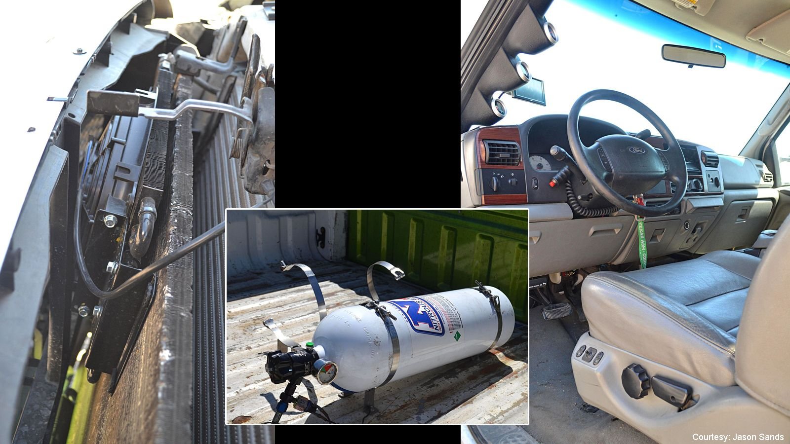

Up front, an oversize transmission cooler helps preserve all that work Ross put in on the transmission and keeps the torque converter performing flawlessly. Outback, he installed mounts to carry two 15 lb nitrous oxide bottles at once, eliminating the time-consuming task of trading bottles between runs. Ross runs in the 11.90 class which allows him to race without a roll cage, so he kept the interior of his Ford mostly stock. Beige leather never goes out of style.
