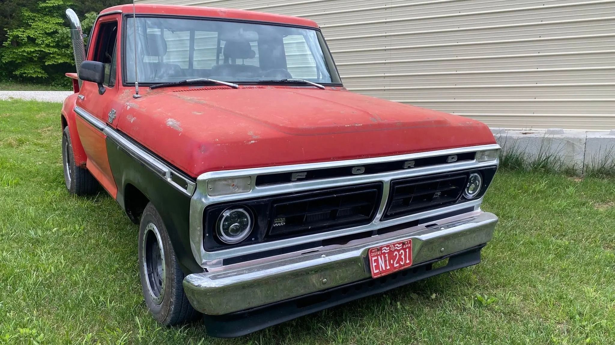

Cheap Beginnings
"Basically, I picked up the '77 F100 for cheap," Heerboth told The Drive. "Got it running. Figured out the transmission only had reverse and the block was so full of lime and corrosion [that] it wasn’t salvageable. Then, [I] had a friend of a friend who had a Lexus LS400 with a title that had been triple signed, so [he] wasn’t able to get it legit. I picked it up for $600."

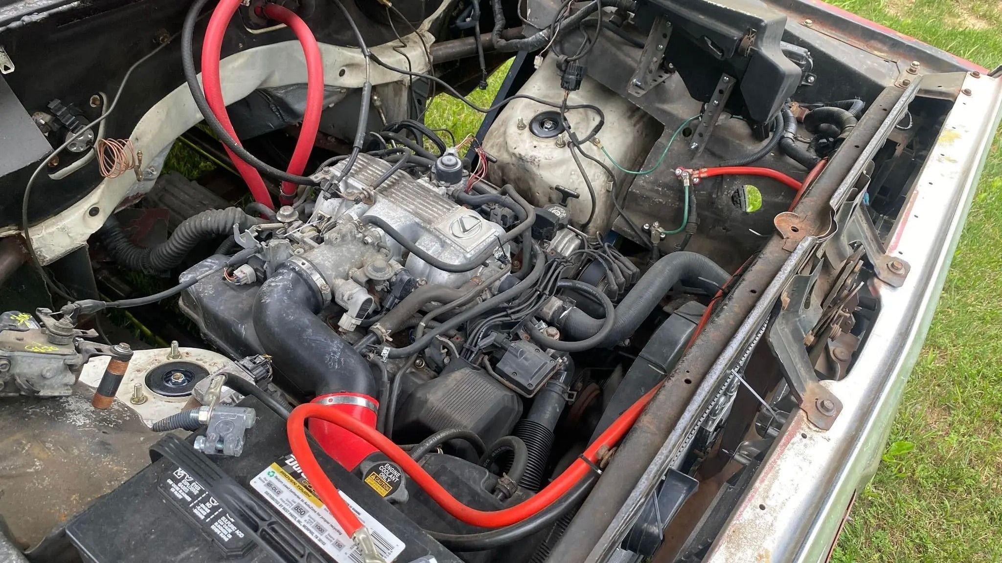

Best of Both Worlds
From there, it just made sense to combine the best of both of these vehicles into one mad creation. "We dropped the [Lexus] motor and trans back [in the truck] the transmission mount was in the same place as the original C4," Heerboth said. "It literally lined up like it was meant to. The truck [also] had a one-piece driveshaft and the car has a two-piece. When I connected to the trans, the carrier bearing sat perfectly under the rear cab crossmember, so it would be easy to mount."

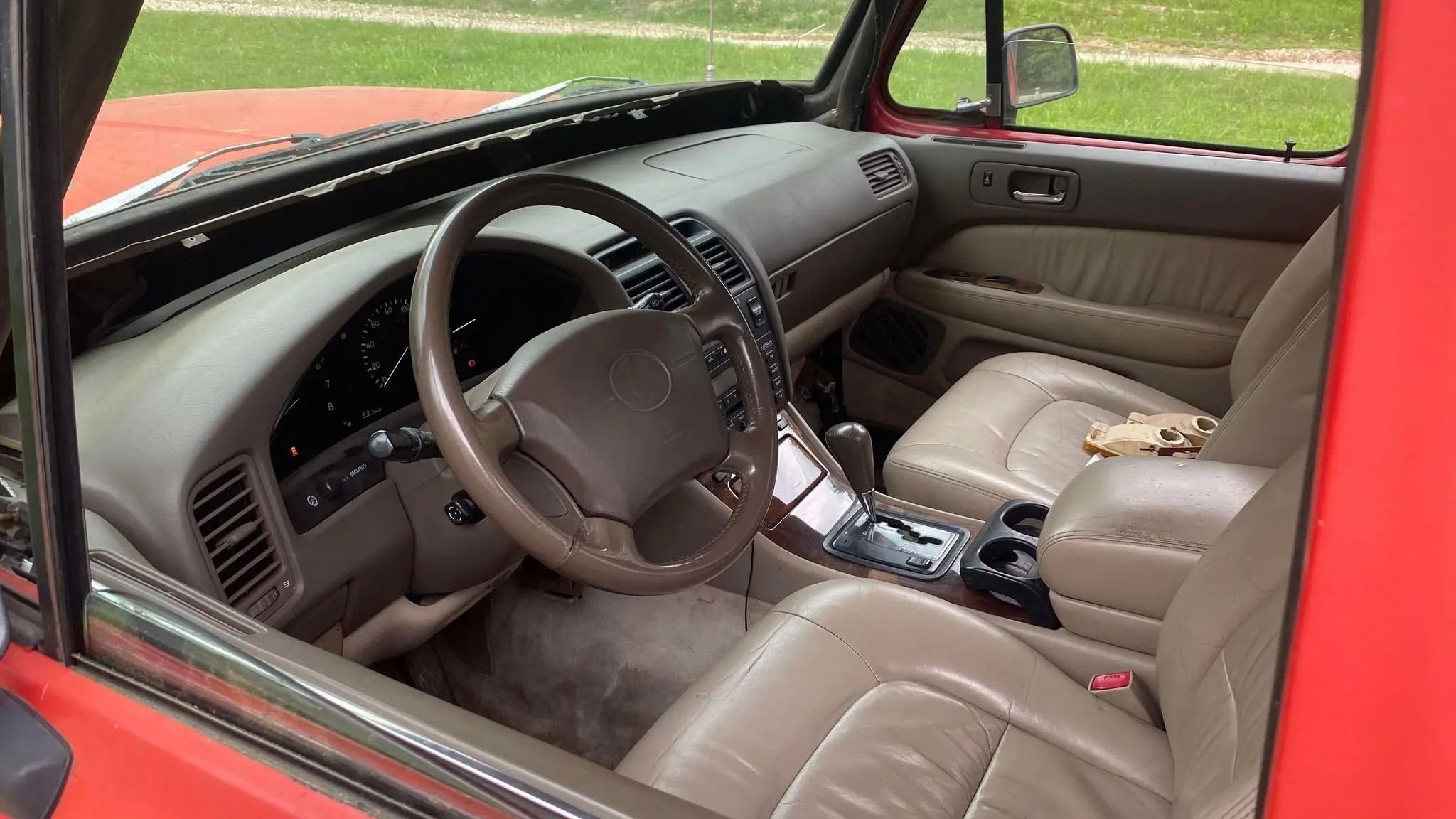

Everything Works
Shocking, even the LS400's dashboard fit neatly in the old F-100, even though these two vehicles couldn't be any more different. Heerboth went to the trouble of ensuring that everything works, too. "Power windows, heated power leather seats, cruise control, it's all functional," he said. "Even the power height adjustment for the shoulder belt works."

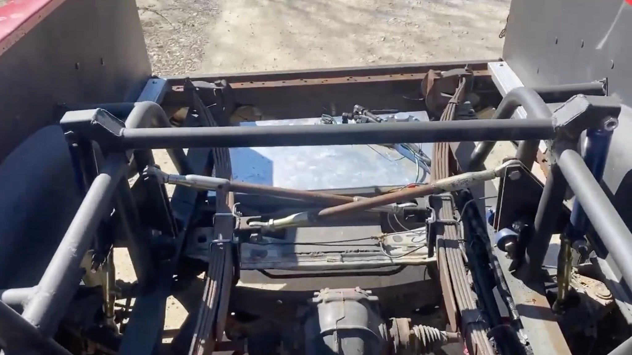

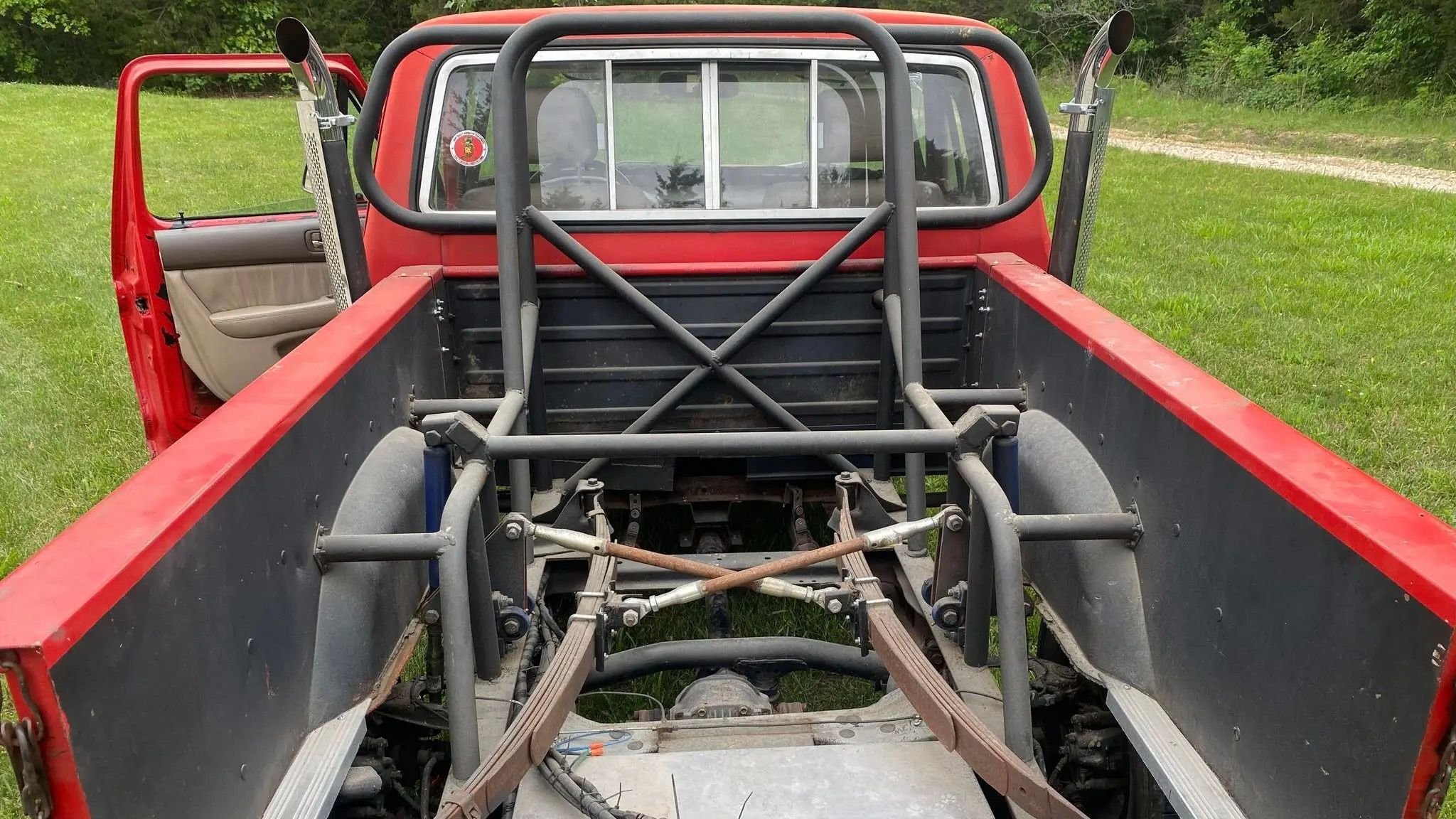

Unique Setup
If all of that isn't crazy enough, what really sets this F-100 apart is its wild suspension setup. Something like what one would find in a Formula 1 racer, the shocks are mounted above the rod ends that connect to the wishbones, while the leaf springs have been replaced with newer F-150 units.
Photos: Tim Heerboth
Budget Driven
The only reason Heerboth went this unconventional route, it seems, is because the LS400's struts were too long to use in the pickup, and this is a proper budget build. Thus, he got seriously creative and came up with something that makes this perhaps the most unique vintage F-100 on the planet.
