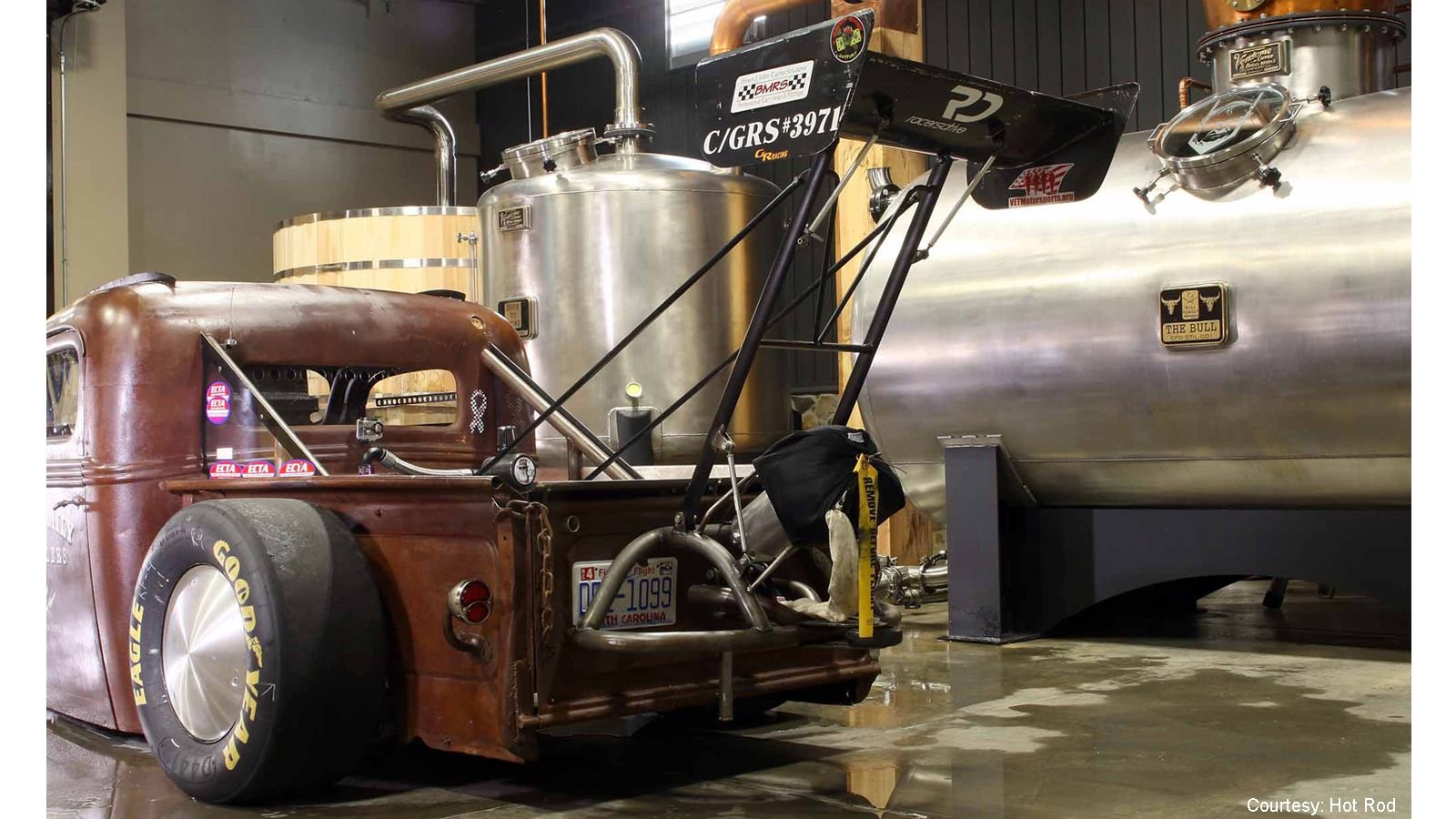

Back in his North Carolina shop, he and his crew began work on the race truck. They tried to keep the soul of the original shell while reducing its overall size. They narrowed the truck by 6 inches, shortened it by 21, and chopped 5 out of the top. They chose a 1932 grille for its smaller dimensions—better to cut through the wind. He found a truck bed lying around, and thinks it's circa 1940. The doors, bed panels, and tailgate remained stock. Brown and company attached the cab and a Ford 9-inch rearend to his chassis jig and went to work.

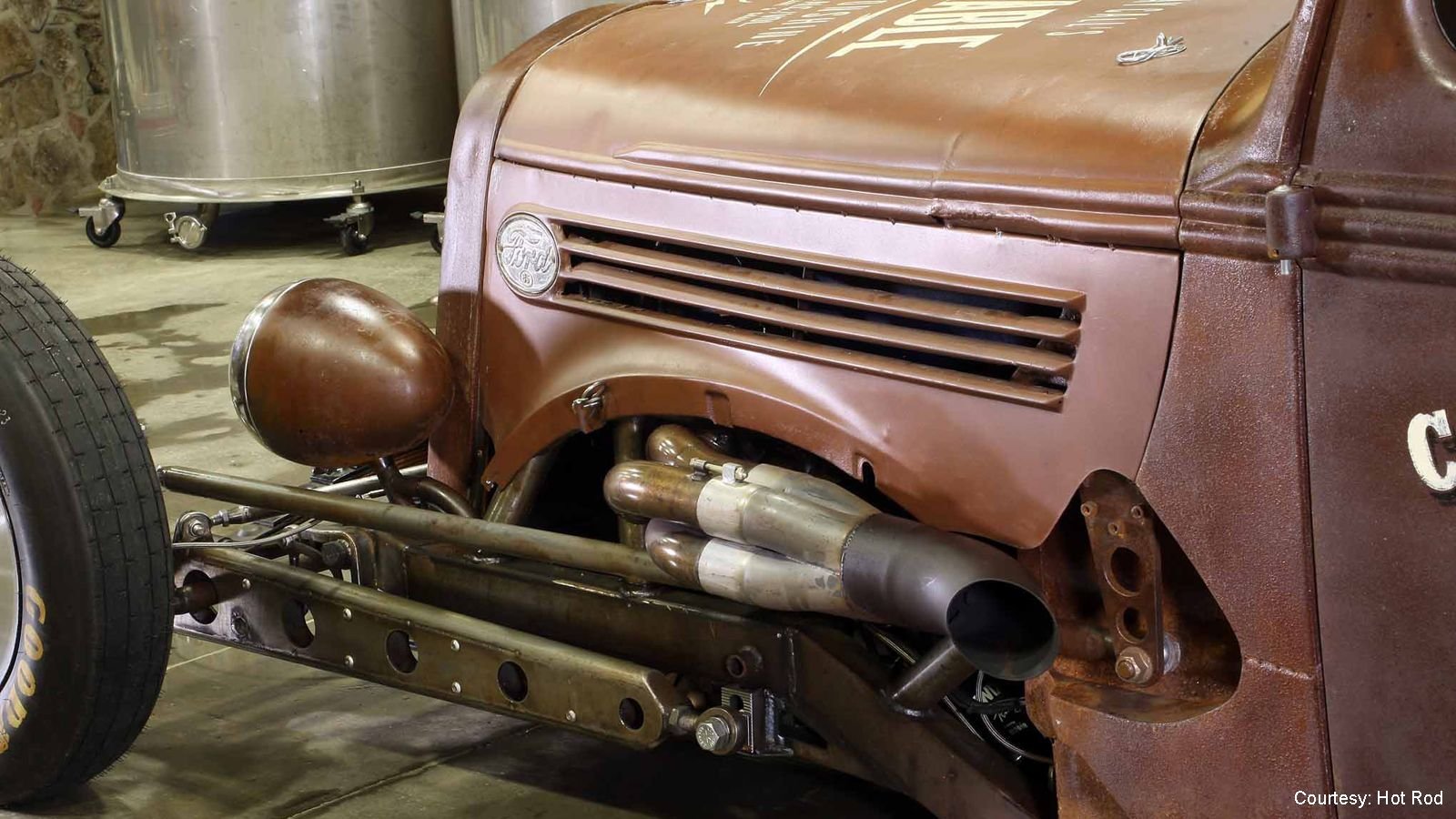

All that NASCAR experience was put to good use when it came time to build the chassis. Brown started with a tube frame and utilized a NASCAR type truck-arm rear suspension set-up from Roush-Yates, including the differential housing and rear axles. The front suspension continues the traditional hot rod theme in appearance, but it's actually a custom design by Brown, with fabricated radius arms and cantilevered shocks. He says he built the front end on the fly and never resorted to pen and paper. Experience pays, and it saves trees.

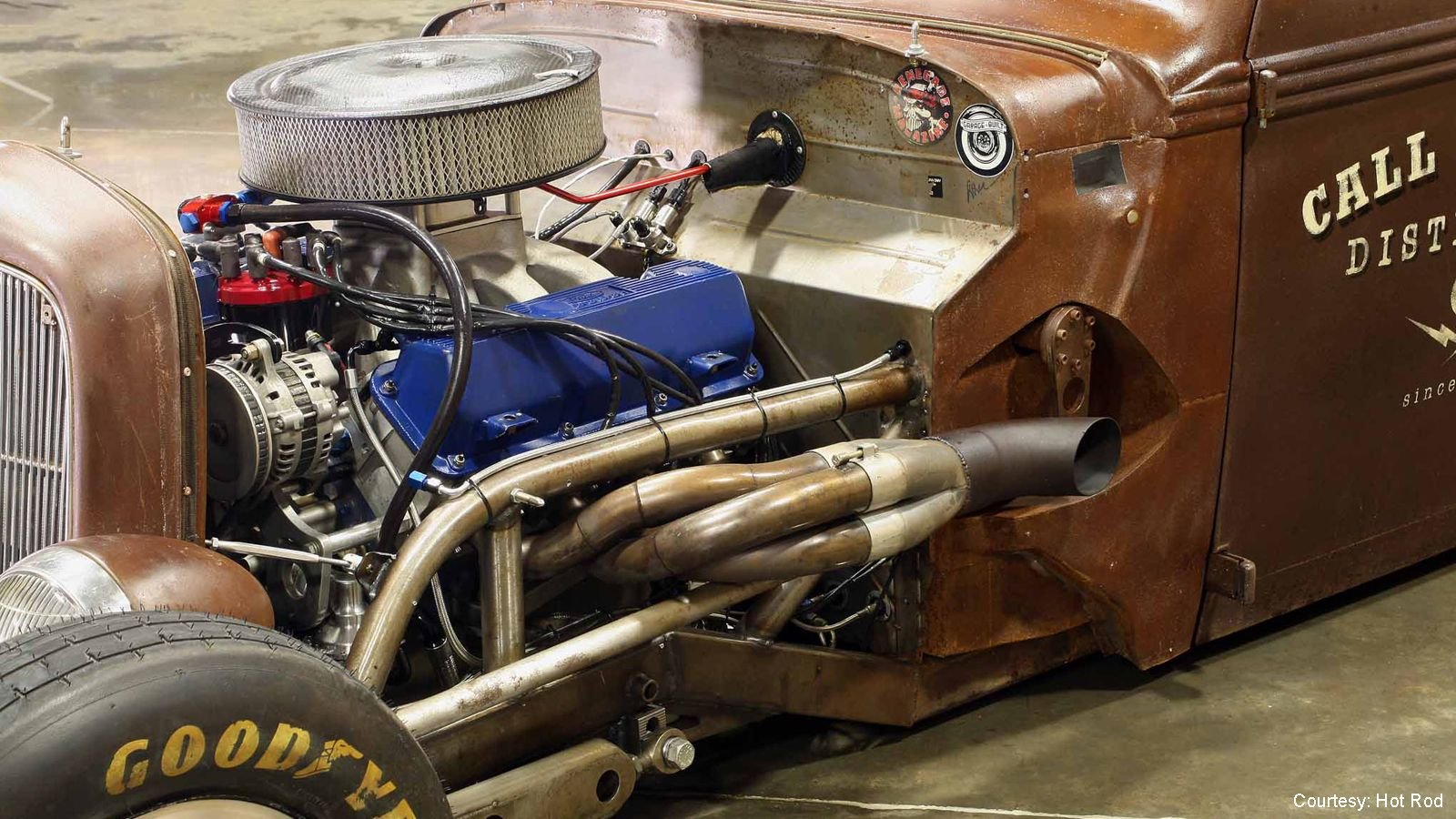

Also from the land of the left turns is the 358ci Ford race engine, with Yates heads, that puts out 715 hp to the rear wheels. The rear wing came from the the world of the drag strip. Brown felt the narrowed drag car wing would help with stability, he explained, "It turns out the truck drives pretty well at 190 mph without it. I ran it when I checked out with the ECTA, but now for land-speed racing we take it off. We call it the ‘training wheels’ because it really settles the back end and makes the truck very stable, but it does slow you down a bit, so it comes off when we are trying to set records.”
