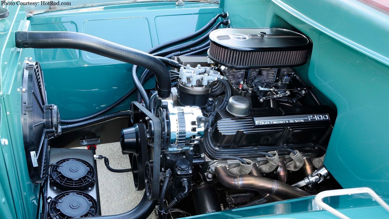

Under that weather worn hood lies something you definitely wouldn't expect. Amid the smoothed out and nicely painted inner fenders and firewall lies a Ford Performance crate 427ci V8. The big little motor is loaded with goodies too, including a Scat forged steel crank, forged steel H-beam connecting rods, forged Mahle pistons, a hydraulic roller cam, Ford Performance aluminum “X” heads, Edelbrock Performer RPM Air-Gap intake, and Holley Ultra Street Avenger 770 CFM carb. Stainless steel headers carry exhaust fumes out through a 2.5" exhaust and Magnaflow mufflers. You're eyes aren't fooling you either, the engine sits 7 inches further back in the chassis to improve weight distribution because...

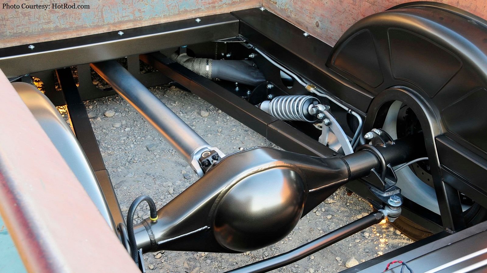

While most guys would slap on some shocks and lowering blocks, and call it a day, Jon wanted his '56 to handle just as good as it goes. So he called up No Limit Engineering, and ordered one of their Big 10 chassis setups. Inside you'll find custom front and rear crossmembers and a center X-member designed to eliminate flex. A Currie 9-inch rear end with 4.10 gears puts the power to the pavement. Then, there's a host of top notch No Limit suspension parts including trailing arms, Panhard bar, billet coilover shocks, Wide Ride IFS with tubular upper and lower control arms, and an antisway bar. Bringing all that mass to a halt are huge Wilwood front and rear rotors, and multi piston calipers
