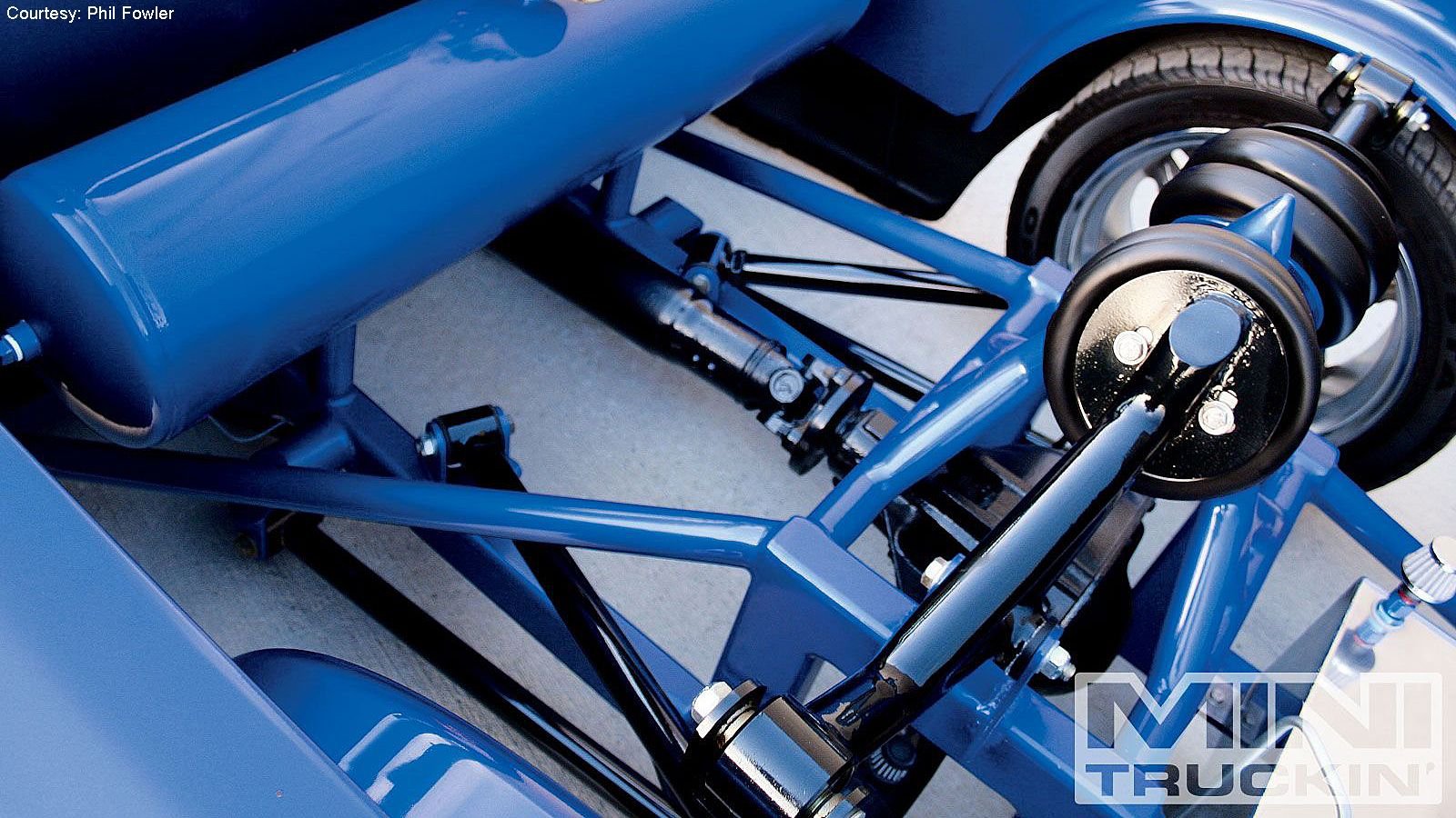

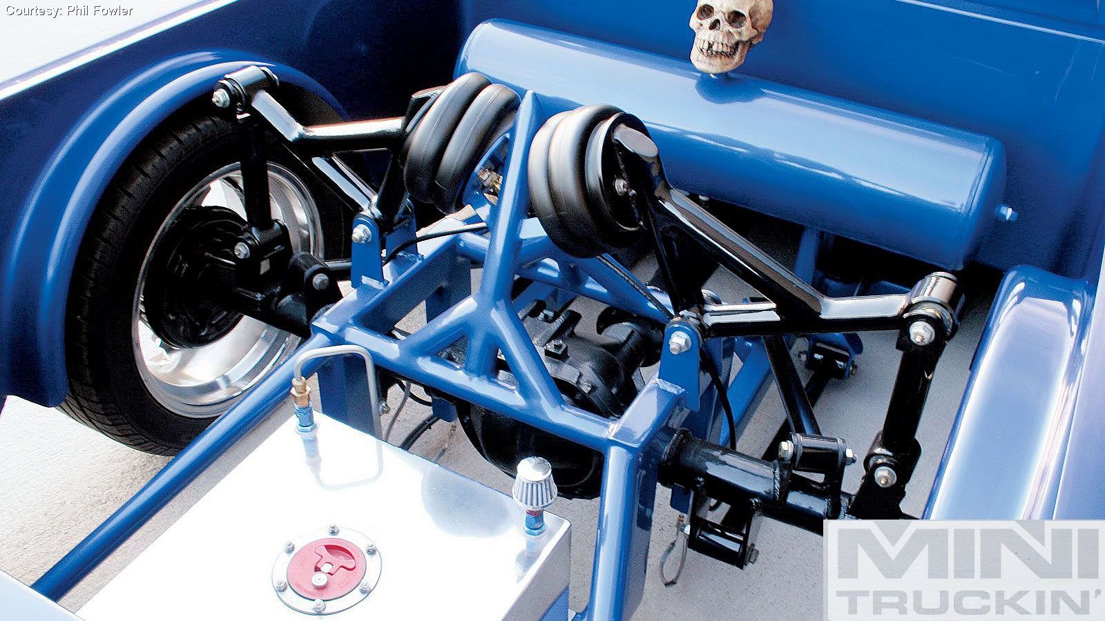

Suspension surgery in the front meant adding Slam Specialties RE-6 bags on Suicide doors bag mounts, mounted to DJM 3-inch-drop I-beams. The Ranger's rear suspension is a custom-built cantilever system that required the bed of the floor be removed to make room for all the working parts to work. Parts include a Suicidedoors four-link set-up and Slam Specialties RE-7 bags, with air for the whole system coming from an engine-driven York 210 compressor utilizing 1/2-inch GC 450 valves. Salatino fabricated the fame from the firewall rearward to allow the three-and-one-half inch body drop.

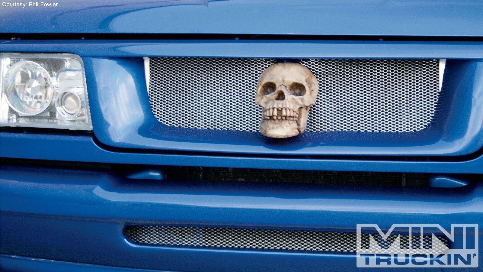

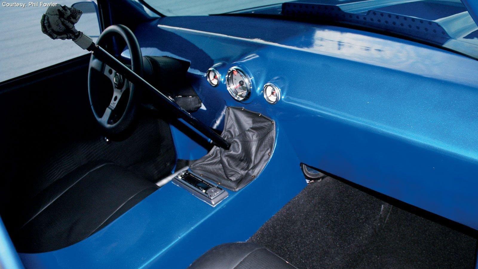

The body wasn't just dropped though, it got the full once-over. Salatino shaved the Ranger's emblems, door handles, wiper cowl, roll pan, tailgate, stake pockets, ugly third brake light, taillamps, cab seams, fuel filler door, and antenna. As mentioned earlier, the bed's floor was no more, but most of the bed went with it as well. Likewise, the firewall went under the knife and the front fender wells went bye-bye too. Additions consist of a sliding cloth top, an AIM hood, and Salatino's skull-sporting custom-made grille. When it was done the pickup was repainted again—including the handbuilt custom interior—this time by CJ Pettit and Jeremy Cyphert in a custom-mixed blue from Valspar.

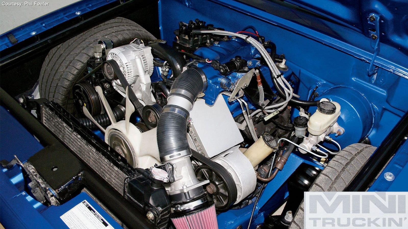

The Ranger retains its 3.0-liter V6, albeit in slightly breathed-on form, with a custom-made cold-air intake and custom-made header-back dual exhaust rounding out the package. When it's not on the floor the pickup rolls on 245/45R17 Kumho Ecsta 711 tires over Limited 665 17-inch wheels. The transmission tunnel had to be raised four inches to accommodate the body drop, and if you are wondering where all the wiring went, Salatino rerouted the majority of it to its current under-dash location.
