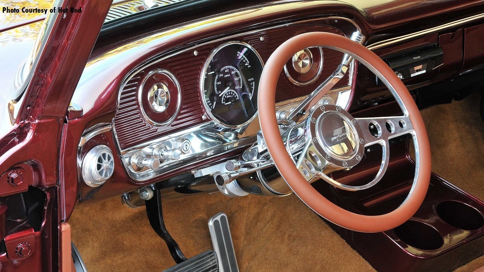

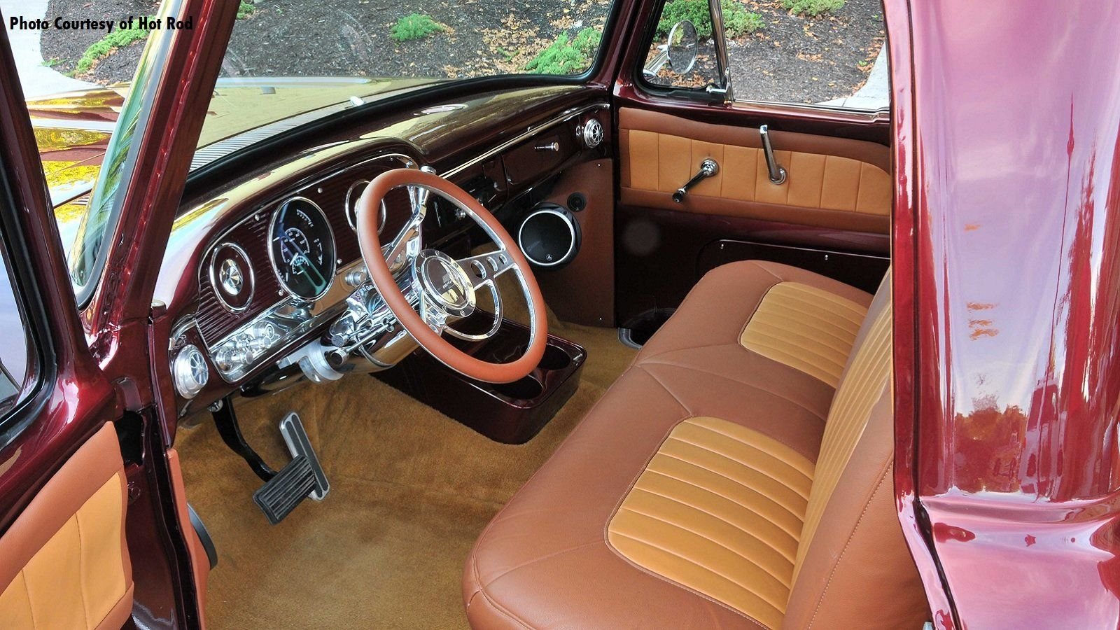

On the interior, the eye-catching red paint continues on the dash, center console, and doors. The dash now houses new air conditioning vents fed by a Vintage Air system. There's a single Dakota Digital VHX Bronco gauge with a polished bezel.
The seats are based on the stock bench seat but are wrapped in tan and buckskin vinyl. The headliner follows a similar recipe but is made from perforated vinyl. Brown carpet is mounted underfoot to ties in the varying shades of brown and tan.

Riner went to work on the center console and didn't forget to include cup holders for his 40 oz. Big Gulps. The console also has other practical functions, like housing the switches for the air suspension, the gauges to monitor the system, and a 7-inch Pioneer flip up head unit. The Pioneer unit feeds JL Audio 5.25 inch speakers and twin 10-inch subwoofers mounted behind the seat.
