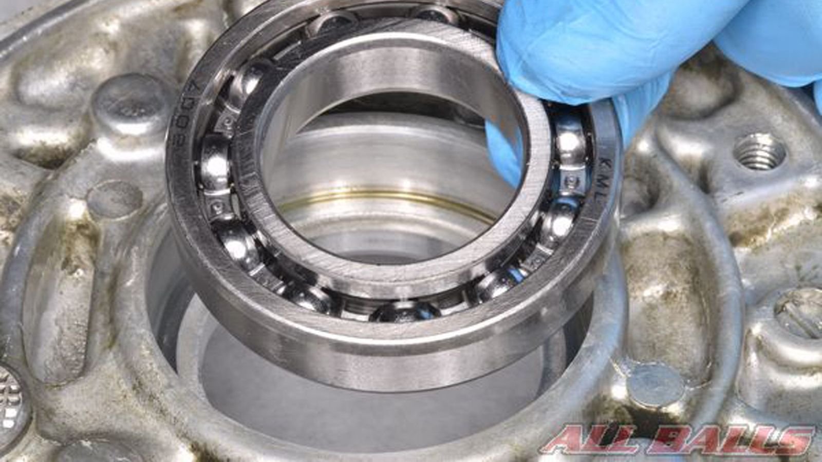

Bearing/Shaft Removal
Some manufacturers never position ball or roller bearings inside blind holes, i.e. inside of a part or casting that has only one open side, but they aren't all that courteous. And even in situations when a bearing or shaft can be pressed out, a little heat can help ease that process—especially since not every shop has a press or a huge selection of specialized bearing pullers. Heat is even more valuable when you need to extract a bearing, bushing or shaft from something old and aluminum, or older and made from pot metal. A particularly neat trick is to heat up soft metal castings that hold a bearing—not so hot that it would distort the metal, a couple hundred degrees Fahrenheit is enough—then, wearing gloves, slap the casting down onto a piece of wood, and the bearing will pop right out. Help from heat always beats pounding or prying parts out when it comes to preventing damage.

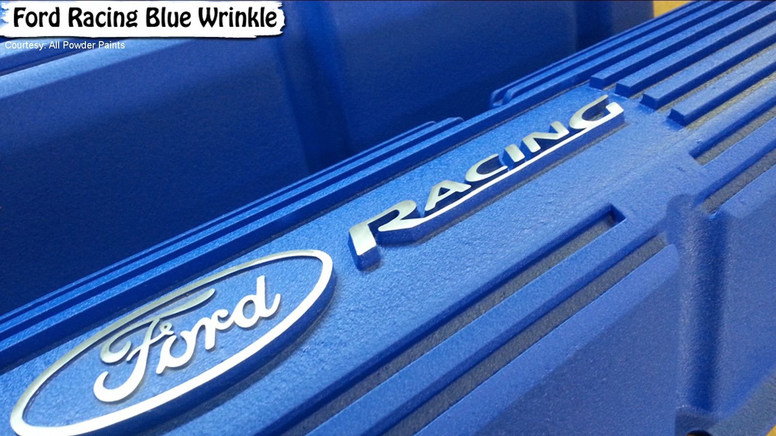

Wrinkle Finish
Know what else needs to be heat-cured? Right, parts painted with wrinkle finish—sometimes called crackle finish—paint. As with powder coating, it takes a bit of practice to get the system down, so practice on expendable parts first, or just go into it keeping in mind the very real possibility that you'll end up stripping off your first few attempts. Unlike powder coating, wrinkle painting is a bit of a black art—balancing the number and thickness of coats with the temperature and duration of curing is a skill, but it's like a magic trick once you've acquired it.
 >>Join the conversation about the uses of a shop oven right here in Ford-trucks.com.

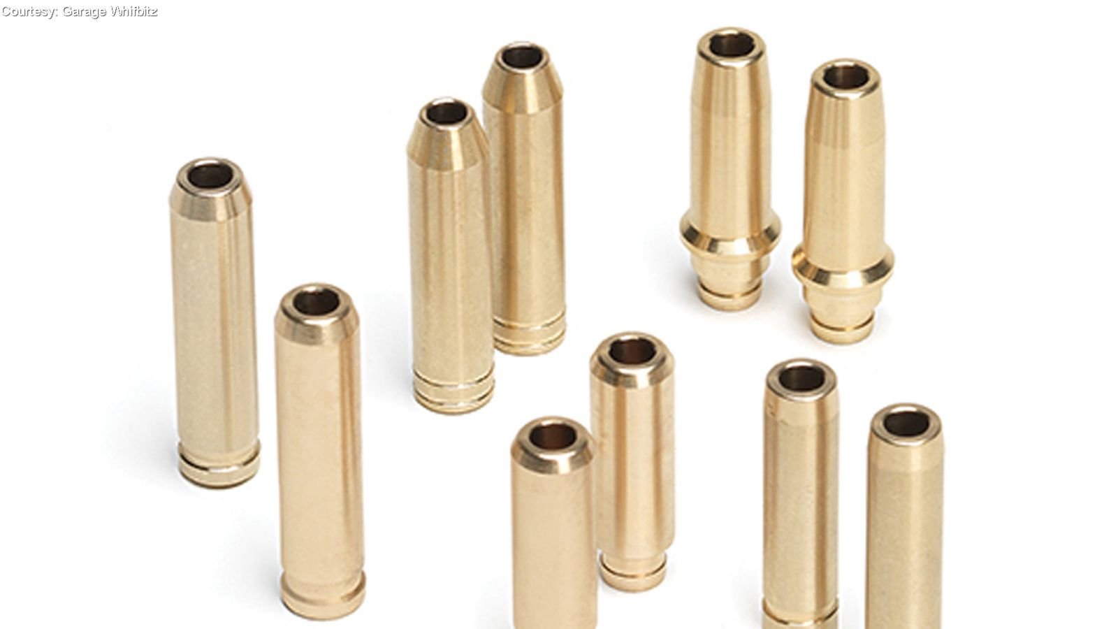

Press-in Prep
Another situation where heating an entire part comes in handy is when pressing parts into castings, especially aluminum castings. Heating a casting easily and evenly expands its dimensions, and makes size-on-size or press-fit installations possible. Not all engine blocks are aluminum, and not all will fit in your shop oven, but heating up aluminum blocks for press-in cylinder liners is a time-honored technique in some applications, as is heating cylinder heads for press-in valve guides.

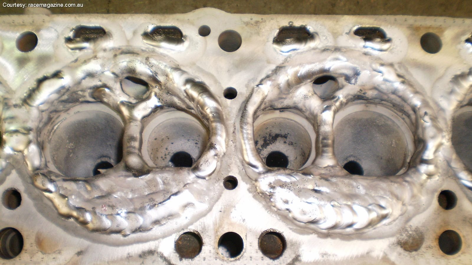

Weld Prep
Another technique as old as time, or at least as old as welding, is preheating parts that need to be welded. Welding large parts—again, especially aluminum castings—is difficult because the pieces act like huge heat sinks and suck heat away from the weld. Heating the piece up immediately before welding, and wrapping the part in a heat blanket while welding, will make for nicer results.

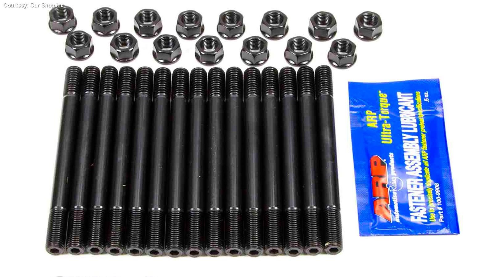

Stud Removal
While we're still heating up castings—we said there would be different uses for the oven, we didn't say how different—let's use that heat to take things out, rather than put them in. Torches are great for freeing stuck bolts and other parts you are just going to replace, but some torches are too hot for castings, and others, like butane torches, are too cold. Too much heat will distort, weaken, or crack some castings, and others castings will either just not heat up, or not hold the heat where you want it. You can't bake a turkey by holding a torch to its wing. Heating up a whole piece when you want to remove a stud will save the casting's internal threads, and will break the bond created by chemical threadlockers.
