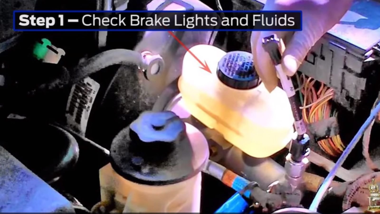

Step 1 - Check the brake lights and fluids
Many times, the problem can be solved at this step.
  • Make sure your rear brake lights are working.
  • Check your brake fluid level. If it's below "Minimum," top it up to "Maximum."
Pro Tip
ABS sensors can tell when brake fluid levels are low. Therefore, the ABS light could go on just because your brake fluid is a little low.
If the light doesn't turn off at this point, go to Step 2.

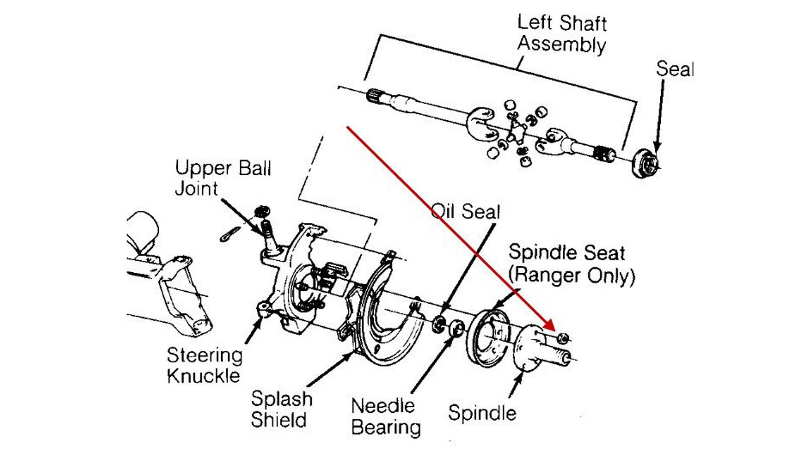

Step 3 - Check the ABS sensors
The sensors are located on the back of the drums on the rear brakes. If you have rear disc brakes, they are on the steering knuckle.
>>Join the conversation about why your ABS light might be on right here in Ford-trucks.com.
    Step 3 Continued...
    • Use a Torx E8 socket to remove the sensor mounting bolt. Then remove the sensor and clean it with WD-40.
    • Hose down the tone rings if they are dirty.
    If the ABS light still stays on, it's time to get electrical and proceed to Step 4.
