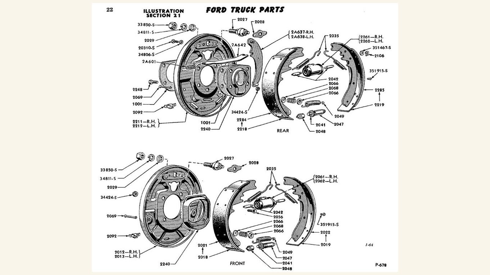

4. Check and Adjust the Brakes
Older trucks don't have the great brakes that modern vehicles do, unless you have upgraded them, and some drum brakes don't adjust themselves. To keep yourself and your truck safe, every spring make sure the metal lines aren't rusting, the rubber lines aren't cracking or bulging and the wheel cylinders aren't leaking. You'll just have to take the tires off to get a good inspection of the shoes or pads, since your classic truck won't have the fancy electronics to tell you. If your truck uses drums and shoes, make sure that you are mindful of the wear and adjust as necessary. Only regular inspections and maintenance will prevent costly repairs.
