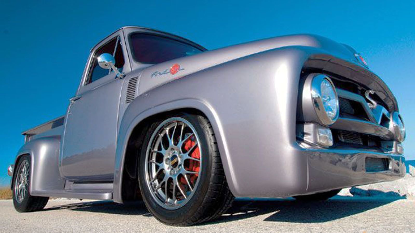

So where does the '55 F-100 come into play? Well, that was found in an old chicken coop and was at first destined to be a shop truck for RPM Ranch, John's shop in Georgia. Ford heard about the vintage truck and approached John about displaying it at the SEMA show and that's when the truck's fate changed. In the span of 18 months, the pickup went from chicken coop homebody to Best in Show, winning hi-po vintage monster. The goal of the build was to keep the original look of the truck while hiding the performance mods for the sake of modesty.

 "The only thing not original is the opening up front for the intercooler and the exhaust out the back." The sheet metal of the body, steel fenders, and the bed are all property of Ford with the powertrain being the same that put the 03 Mustang in the record books. John sent the truck to Randy Powell of Powell Paint and Body in Georgis to make the truck like new with repaired cab corners, fenders, running boards, and bed from Dennis Carpenter. Afterwards, fabricator Graeme "Rabbit" Bartils from North Georgia Fabrications began updating the chassis by boxing the original 55's frame rails and welding in cross bracing.

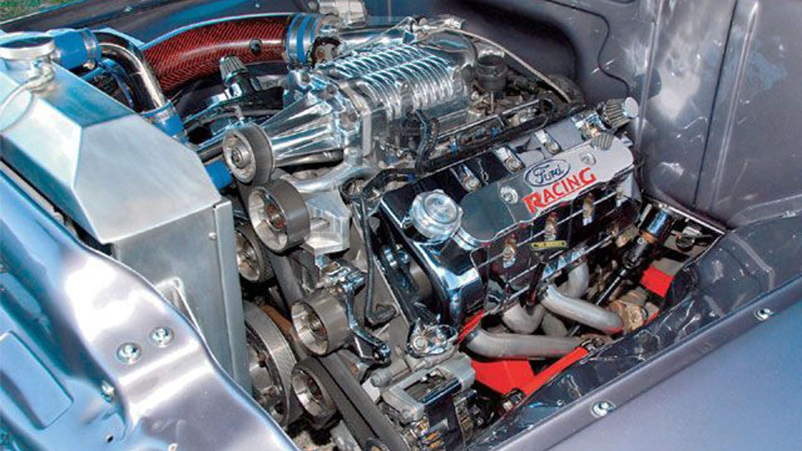

From the title, you already know what's under the hood of this 1955 Blue Oval. John went with a 4.6-liter Cammer engine that was bored and stroked from 261ci to 306ci. Also lending a hand in the name of performance is '03 Cobra Eaton supercharger that was ported and polished for massive gulps of airflow and fitted with Metco under-drive pulleys. A MAF from a Lightning truck, Accufab 100mm throttle-body, and a carbon-fiber air induction system from the good folks at Razors Edge to increase the velocity of the air.

Keeping things cool is a Fluidyne intercooler with an OEM Bosch pump and Autorad high-efficiency radiator. There are also Bosch 55 pound injectors to ensure that plenty of the proper mix of air/fuel and the OEM ignition from the 4.6-liter Cammer creates the necessary precisely timed explosions for function. The final step in the performance sector is the Bassani headers with 2-1/2 inch ceramic coated exhaust and Borla mufflers. The duty of engine building went to Tim Matherly of MV Performance in Statham, Georgis using a Diablo tuner to get the truck to 510 horsepower to the wheels. The transmission was beefed up to T-56 Tremec six-speed transmission paired with an old-school Hurst shifter that kicks so much you know what.
