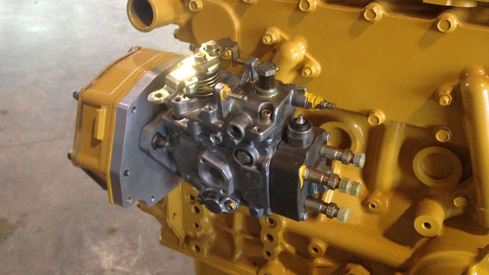

To get the old 'third-gen' back on the road, it needed an engine. While most going down the diesel road would have opted for a Cummins, Tucker turned to a burnt skid steer motor in his shop. Using custom brackets he mounted a Caterpillar 297, four-cylinder, 3044CT diesel engine into the F-100. He then hatched a plan to make even more power.
Custom Pushing
A stock 3044CT is rated for just 80 horsepower and 250lb-ft of torque. Tucker managed to squeeze out an estimated 250 horsepower and 500lb-ft with his trick setup. First, he fabricated a custom adapter plate to upgrade the injection pump to a Bosch VE/Zexel hybrid unit capable of pushing much more fuel to the reconditioned and overflowed injectors.
