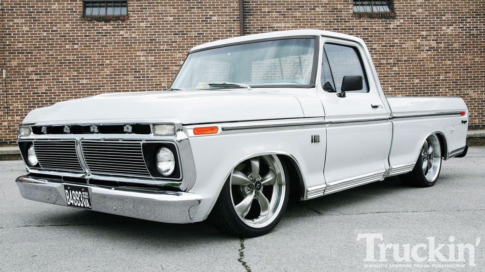

When the Harrells got the '74 home, they gave it a once-over. It looked better than it had in the internet auction photos, but there was room left for improvement. They stripped the frame down and repainted it flat black, then turned their attention towards getting the pickup a little closer to the ground. Up front, they went with the stock spindles and I-beams, though one source mentions they initially utilized Chassis Tech 3-inch dropped I-beams, together with Firestone airbags with Ride Tech Big Red valves and Toxic shocks.

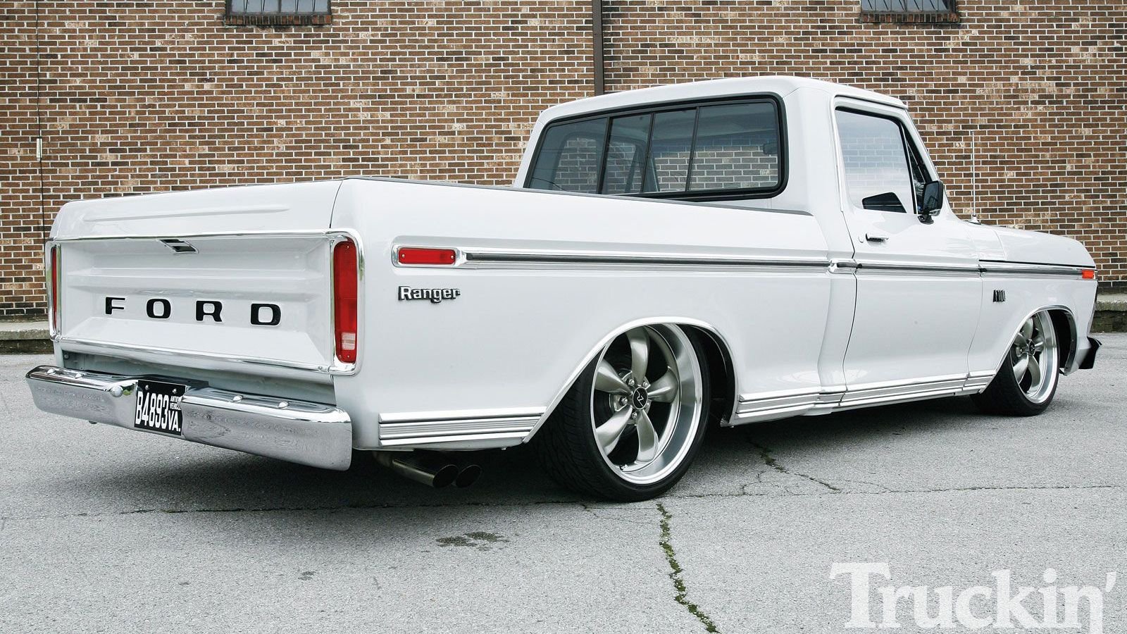

In the back of the pickup, the Harrells C-notched the frame and added another pair of Firestone airbags on top of the springs to facilitate effortless drops and lifts, (an earlier article mentions the use of a Ride Tech’s AIRoverLeaf kit, with two leafs removed from each spring as well).

The factory Ford brakes the truck had when the Harrells acquired it still stop it, but the 17-inch Generation 1 Lightning wheels it came with had their days numbered. The Harrells instead had wheel spacers specially made so they could install Wheel Replicas' 20-inch Mustang Bullitt wheels with the right backspacing, and wrapped the Bullitt rims in Toyo Proxes 4 tires —255/35R20 front and 295/30R20 rear.

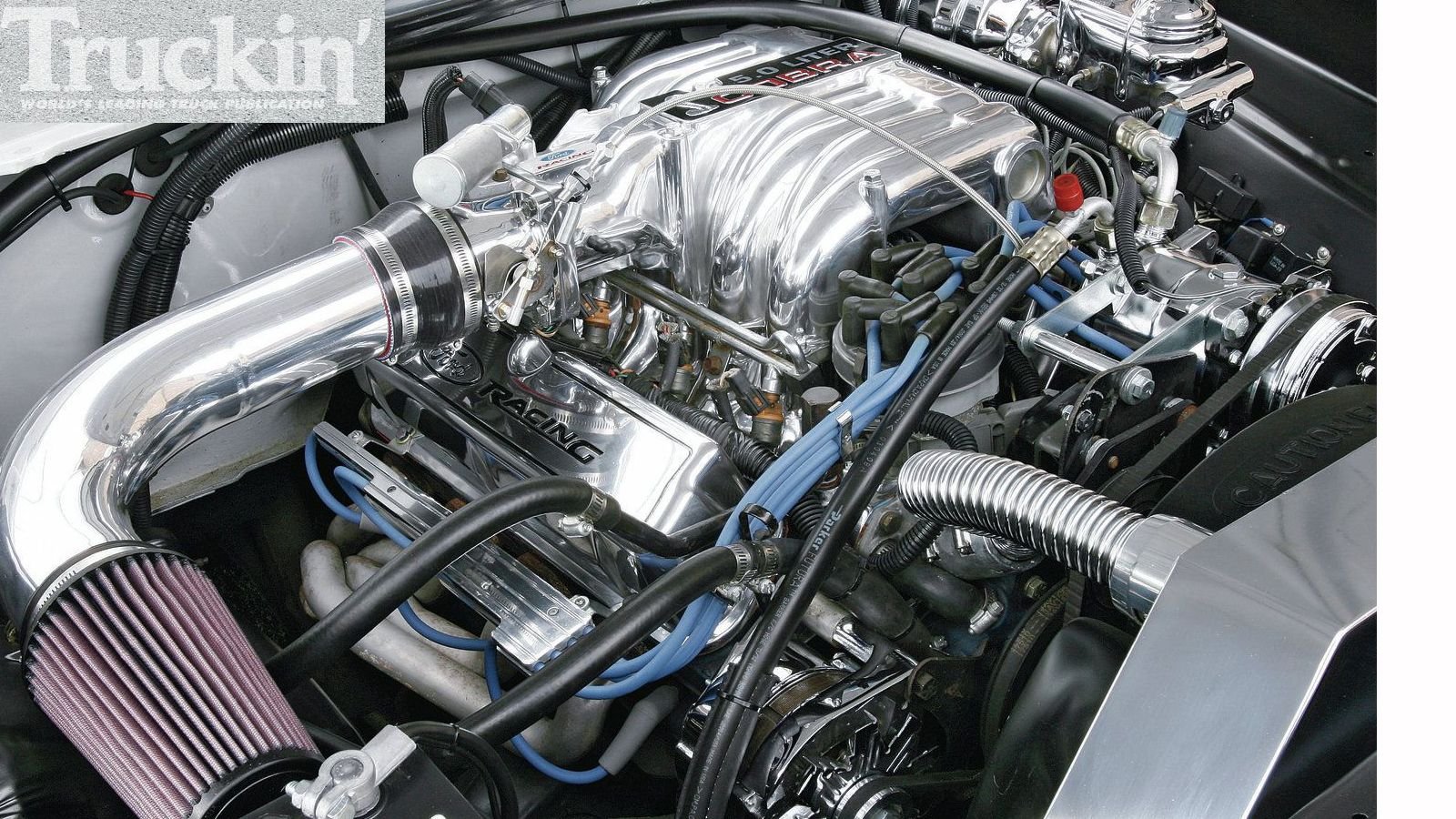

One thing the Harrells didn't build, well not completely, was the Jasper-block 5.0 liter V8 sourced from a 1994 Mustang. It came with an ’88 Ford  F-150 fuel injection set-up, but the Harrells had Josh Tonski from Horsepower Solutions swap in a full EFI system with a high-polish 1993 Mustang Cobra intake manifold, fed by a cold air intake. Horsepower Solutions also added Mustang exhaust manifolds and a custom 2½-inch exhaust system using Flowmaster mufflers. Before the 5.0 went in, the Harrells refinished the engine bay, adding chrome components as they went. The end product looks great and puts out a conservative 265 hp to the rear wheels.

With a re-done frame and engine compartment, the F-100's exterior called for a bit of work to keep up. LMC Truck provided a new, chrome-plated steel grille shell, new front fenders, new trim, and new front and rear chrome-plated steel bumpers. Stateline Collision out of Kingsport, Tennessee handled the painting duties, spraying the '74 light smoke grey and bringing it up to snuff.

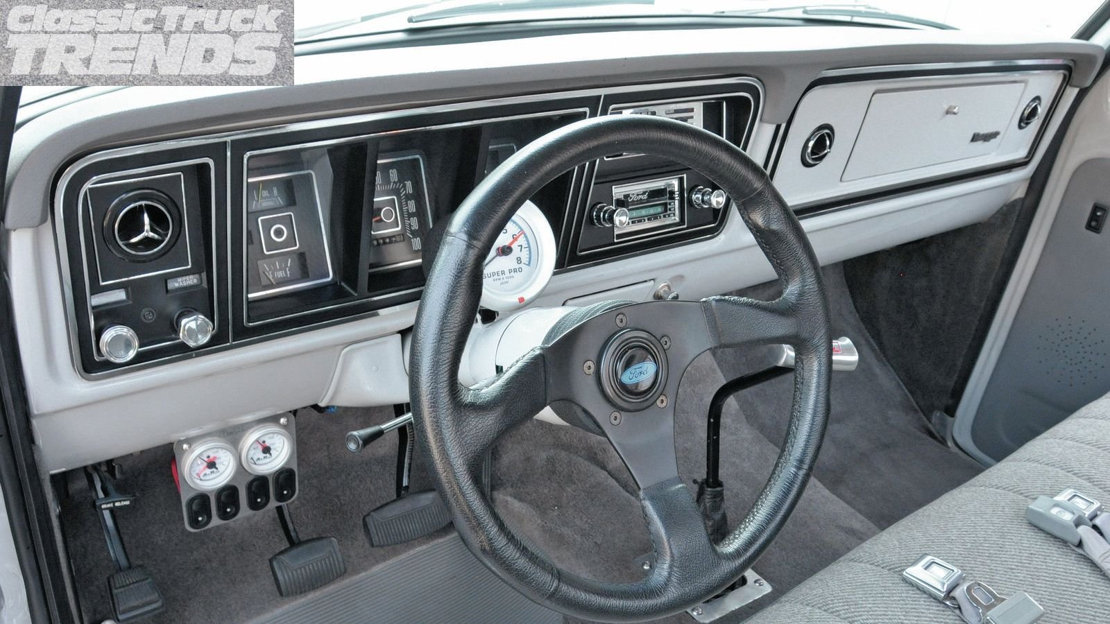

The steel factory dash was also painted body color, and Kingsport Trim Shop was called in to recover the stock bench seat in two-tone tweed upholstery. Rounding out the interior is a Grant steering wheel, a set of Ride Tech switches, a Super Pro tachometer, and coolness via a Vintage Air A/C system.
