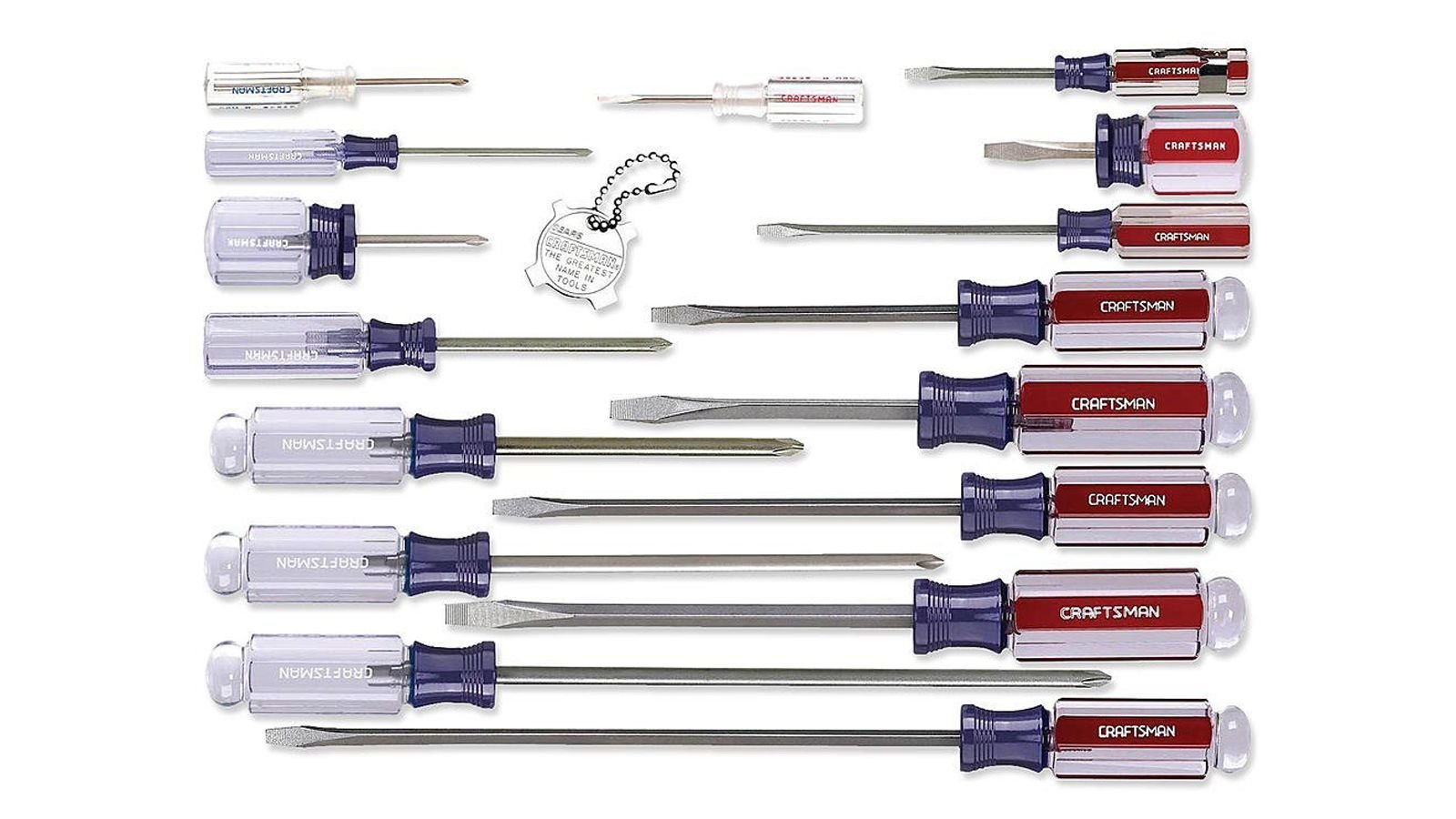

1. Screwdrivers
Gasket scrapers are great tools—nothing works better for scraping unwanted material from delicate surfaces. But good gasket scrapers aren't inexpensive and only come in a limited range of sizes, many are too wide or the handles are too long to reach areas you really want to reach. In addition, especially after a little use, the corners get dull and ineffective for scraping around items like studs. Enter sharpened flat-blade screwdrivers. They already have hard tips that hold an edge well, are cheaper than proper scrapers, and come in a multitude of sizes and shapes. They are most effective when you sharpen only one side, just like a scraper. Nothing cleans stubborn, aged, and burnt-on gasket material from a tight corner or around a stud better. Of course, screwdrivers are typically narrower than a gasket scraper and so are harder to keep flush to your part's surface, so be extra careful not to dig into and score the surface you are trying to prepare.

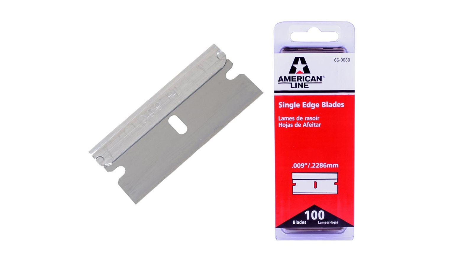

2. Razor Blades
Utility razor blades, the kind with a grip on one side, also work well for cleaning up flat surfaces—but that's an intended use, so it doesn't fit our scope. Recently we were re-watching an old episode of Roadkill and the boys were trying to remove an oil pan that had its gasket fully and completely silicone-ed on. We found ourselves instinctively reaching for a razor blade. It takes a huge amount of force to pry off an oil pan or cam cover that's been glued on with silicone sealant—it's possible to crack or dent the cover, or whatever you happen to be levering against. It's best to break the seal just a bit, after which it's a million times easier to pry off the part in question. That's where razor blades come in. Wear eye protection for this one. In many cases a razor blade can be carefully tapped into the gasket, splitting it like an Oreo, without scratching delicate mounting surfaces. it's easy to crack or snap the blade if any side load is put on it, so be careful. Once the seal is broken in one spot, the mated surfaces will separate much much easier.

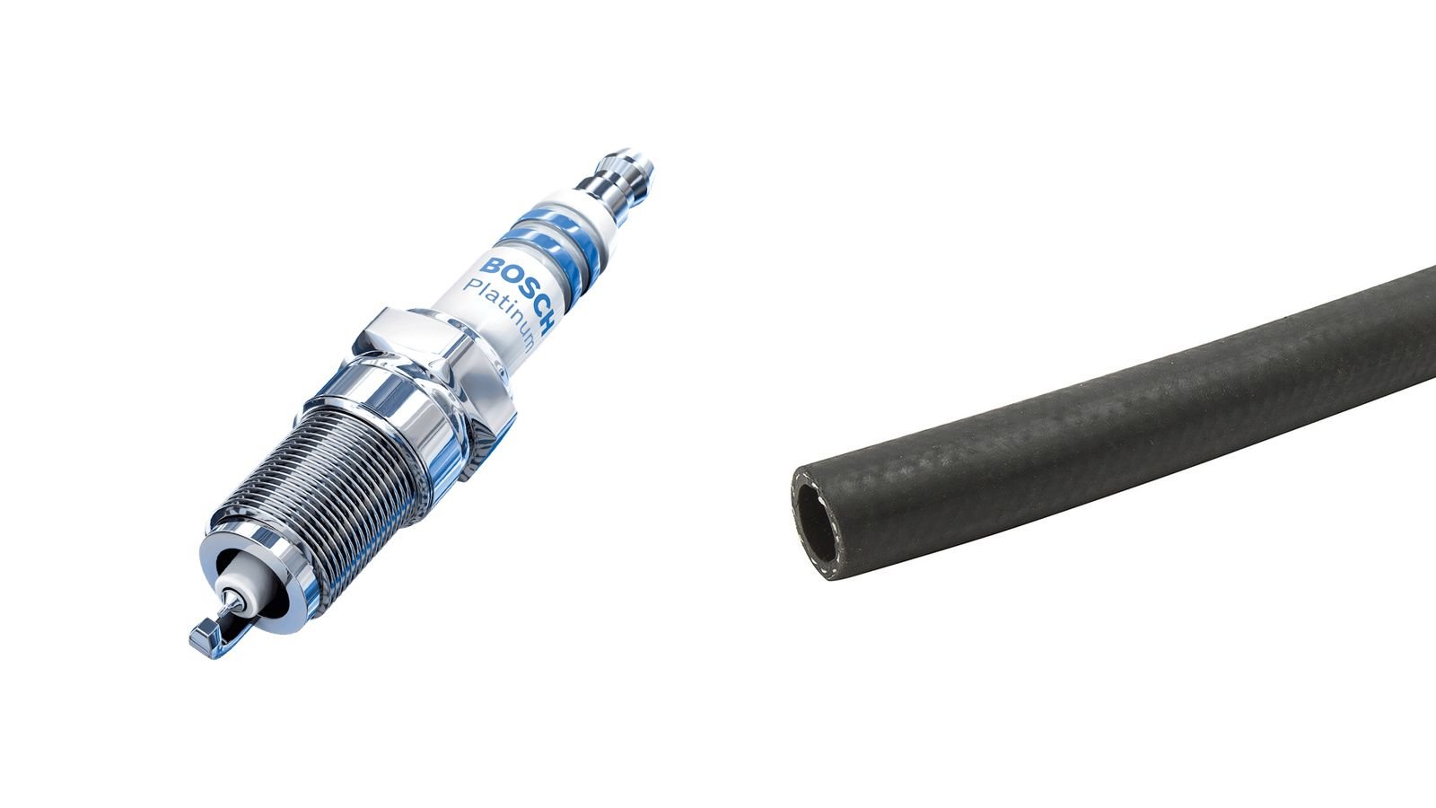

4. Chunk of Hose on Spark Plug
This one is just what it says, a chunk of rubber hose pushed over the end of a spark plug. This works great to start spark plugs in hard-to-reach locations, and it makes it very difficult to cross-thread the plug. The hose should be pushed over the porcelain portion of the plug and can be however long you need it to be. Once the plug is started you can spin it down quickly before removing the hose to properly torque it with a socket.

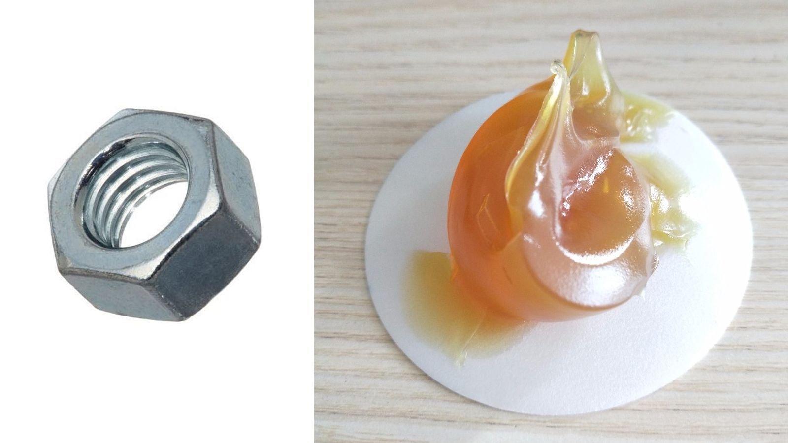

5. Grease or Glue
Magnets work great for grabbing loose nuts and bolts and can even help to start a fastener that's located in a hard to get at spot. But magnets need to be grabbed, and a fist often won't fit in the gap you have for access. Long flexible-handled magnets work in some instances, but take away almost all your feel, making it very difficult to use them to start a nut you can't get to, and even harder to start a nut you can't see. The solution is a small dollop of thick bearing grease, or in even harder to reach spots (or applications where grease would wash away a chemical threadlocker), a bit of glue. The grease or glue will hold the fastener to your finger, in whatever position is best, long enough to get the fastener to contact the threads and turn it that oh-so-crucial first 1/6 of a turn.
