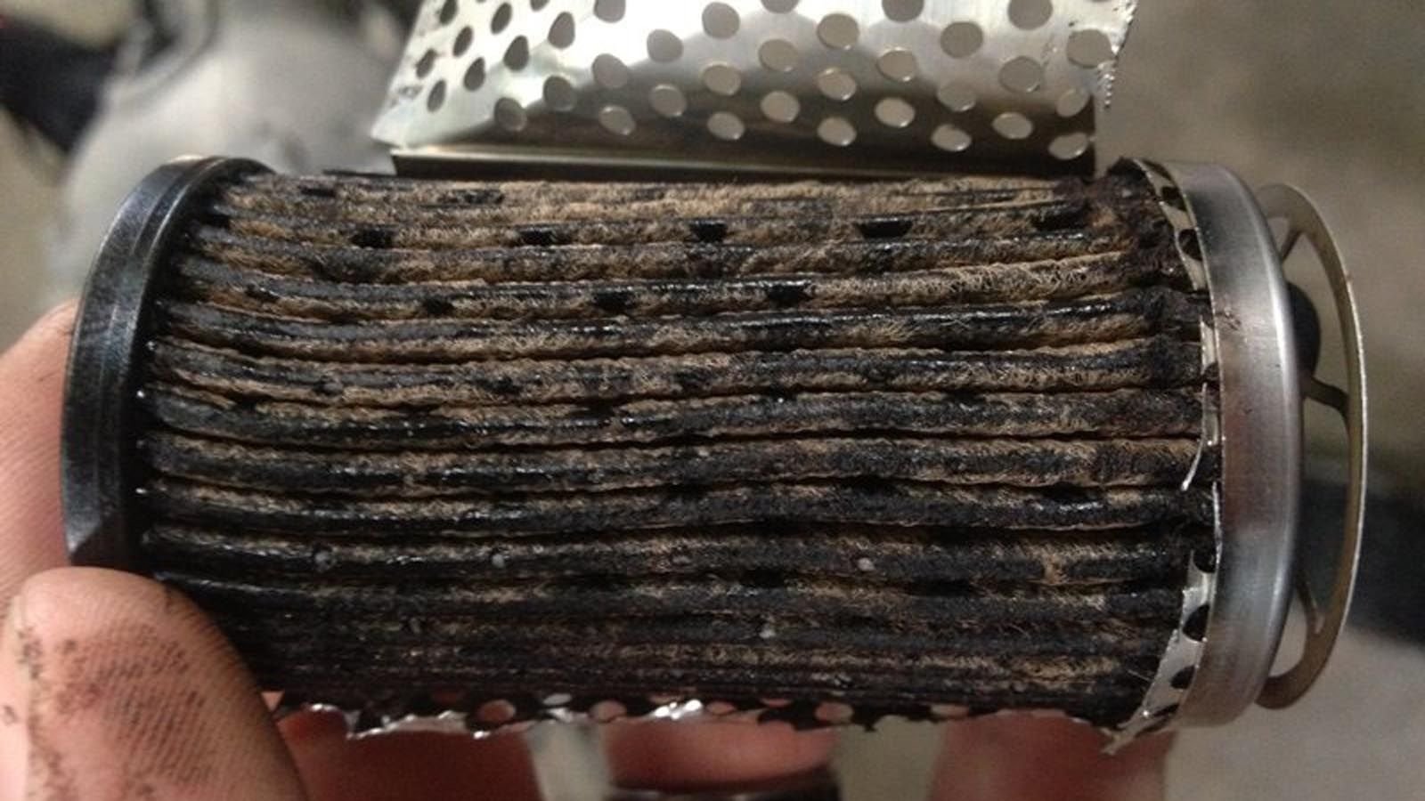

2. Clogged Fuel Filter
If you notice your gas or diesel powered truck sputtering and misfiring during sustained cruising, you'll want to check for a clogged fuel filter. An accumulation of dirt or rust from the fuel tank, or contaminated fuel at a gas station, will cause clogging here. Simply replacing the filter should remedy the misfiring issue, but if it persists then you may have clogged fuel injectors. Keep reading to troubleshoot this next possible culprit.
