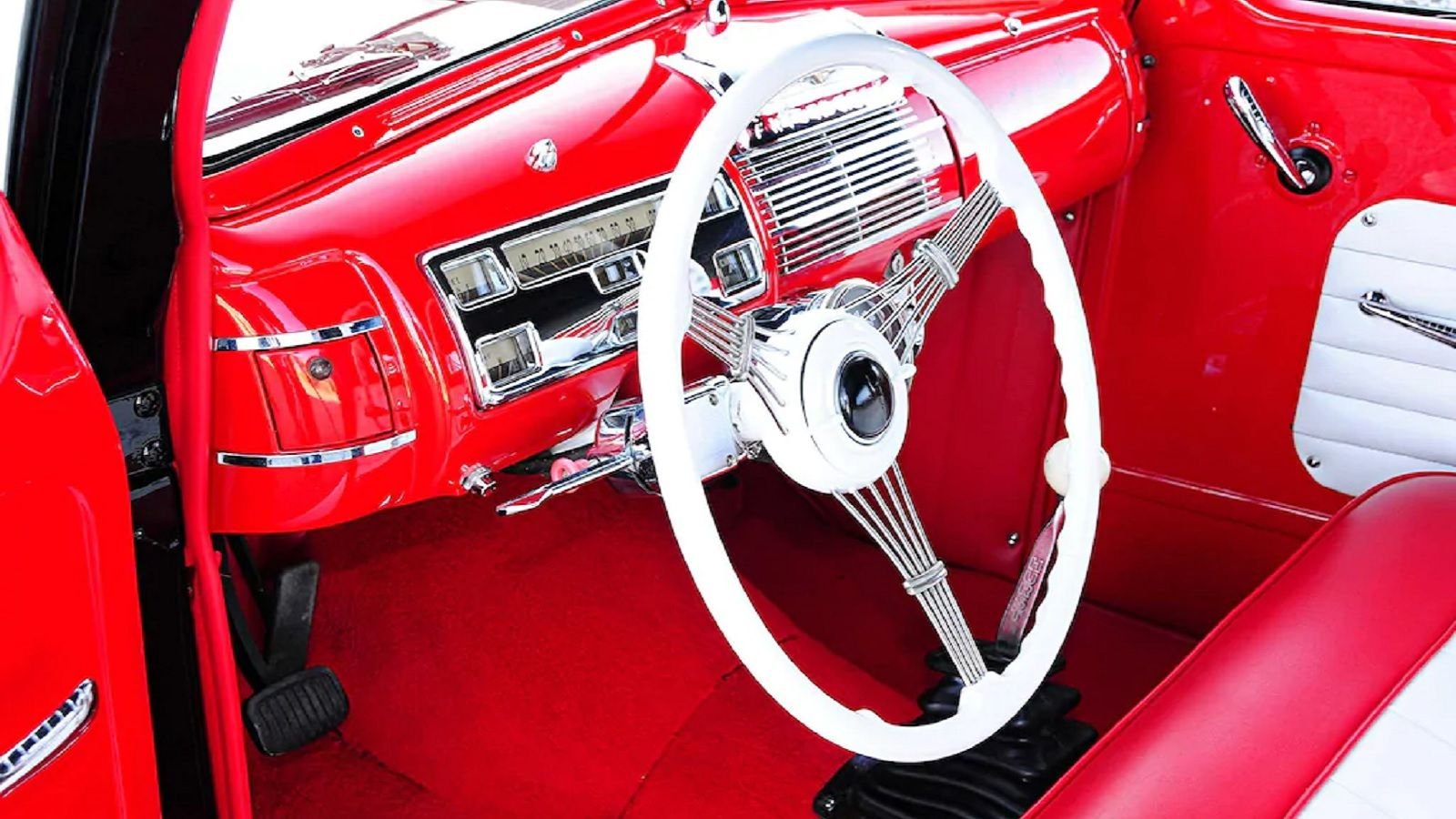

Final touches for some extra dazzle
As if the truck didn’t already look attractive enough, Dylan added some red sheet metal accents to it. Looking on the inside, he added a 1940 Ford dashboard with restored gauges along with a 1937 Ford banjo steering wheel to give the truck a truly unique driving experience. A Speedway Motors wiring harness was next added, along with some red carpet. The original car seats were covered with red and white-pleated vinyl and finally, the running boards were updated to match the new look.
