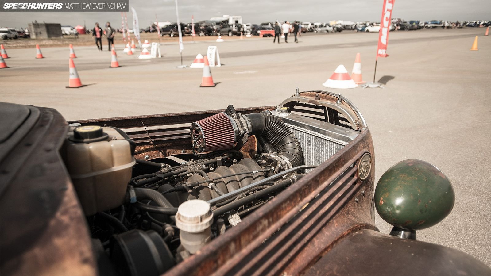

With the Triton pared down to only the pieces Mark could use, his attention turned to finding power. Since the whole idea was to race the truck and to build it for small coin, Mark, lacking any particularly strong Ford brand loyalty at this point, took the road more traveled and went with a 5.7 liter GM LS1 motor— also boneyard fresh. A Tremec T56 6-speed manual transmission takes power from the LS1 back to the factory Mitsubishi rear end that Mark equipped with a locking differential.

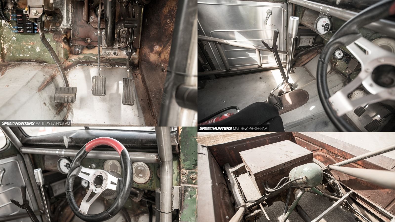

A racing truck can't live on clear enamel alone, so Mark welded in a roll cage that, like the rest of the truck, follows Confederation of Australian Motor Sport specifications to the letter. A single racing seat and OMP 6-point harness hold him securely in place behind a mix of gauges, and window nets keep his limbs inside the car. He reports that the Ford flies through tech inspection, even the bed-mounted steel cylinder he uses for a fuel tank makes the cut. Mark's recent results include a high-speed run of 120mph, and a best quarter-mile elapsed time of 13.54 seconds. He says his truck isn't the fastest thing out there, but considering what he has into it, the project is more than a success—with room to grow. And who can fault a man who brings a piece of 1938 back to life?
