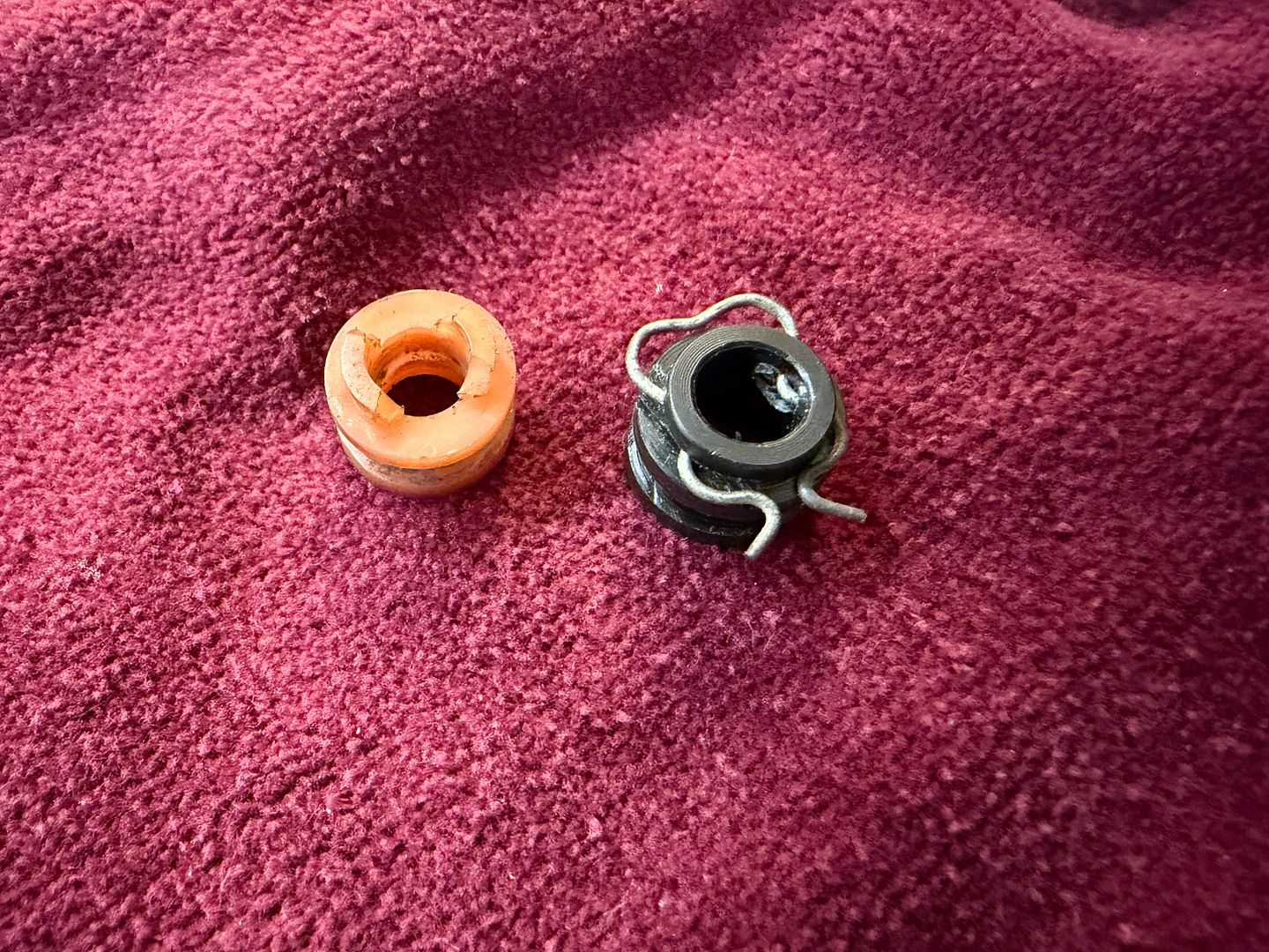

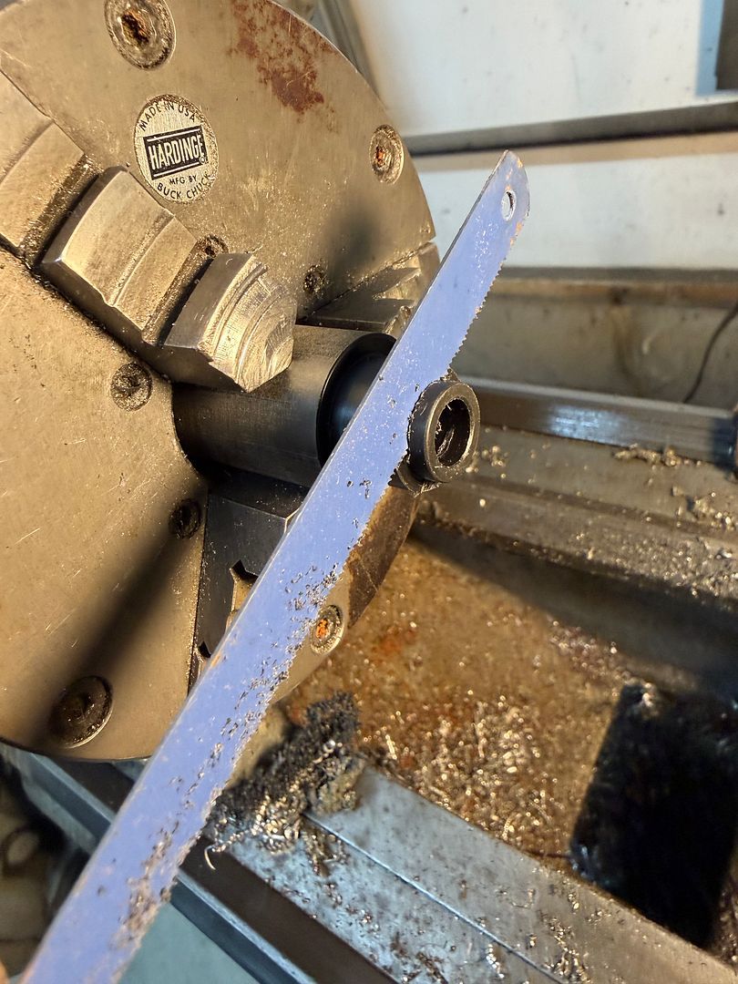

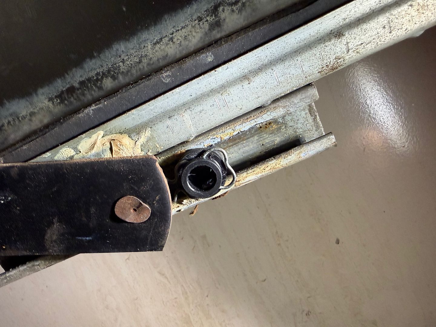

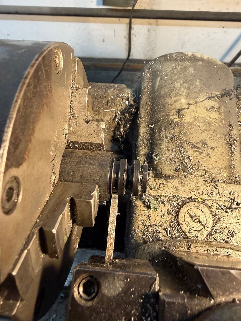

He was one of those guys who appears to think that old vehicles doors don't close properly and need to be slammed. Normally I speak up rather quickly about this but thought to keep quiet to not come across as an ***. Well, as we were about to leave the 4th stop, I heard the window drop as he slammed the door once again. Didn't say anything and didn't check it until I got home. Sure enough, the window did not respond to the window crank action. Opening up the door access panel revealed that the window regulator bushing had broken where it's notched for the spring clip. So I guess this would make a good lessons-learned for anyone else out there with someone that uses a bit too much force in closing doors, those plastic parts inside aren't designed for that sudden stop at the end of a door slam.

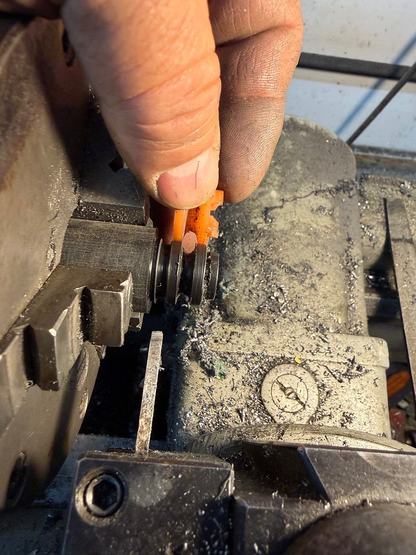

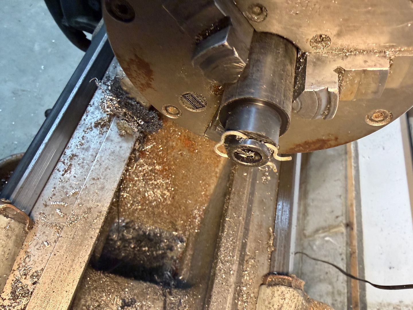

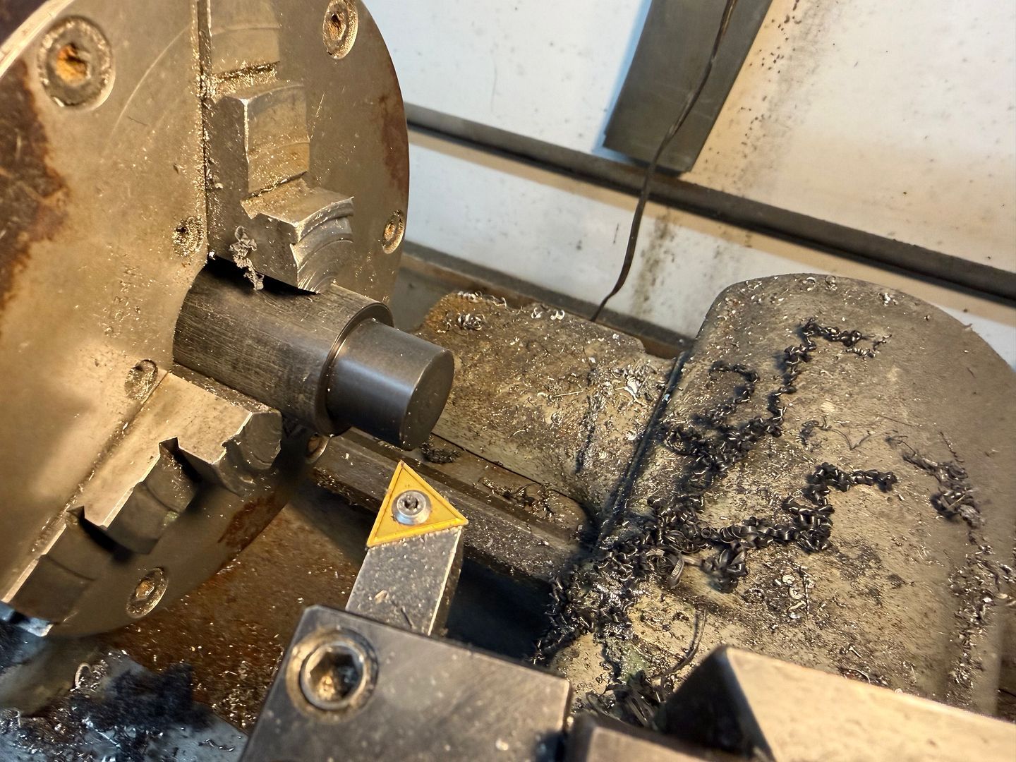

A quick trip to the local auto parts just before closing on Saturday night was fruitless, normally I would expect this to be in the Dorman help section. The counter assistant's research showed that these were only available at Denis Carpenter type outlets, so that didn't bode well for a quick repair. Since I planned on driving the truck on Sunday, let's see what we can do to make one. Some delrin in clamped up in the lathe, turned to size and bored to fit the lift arm

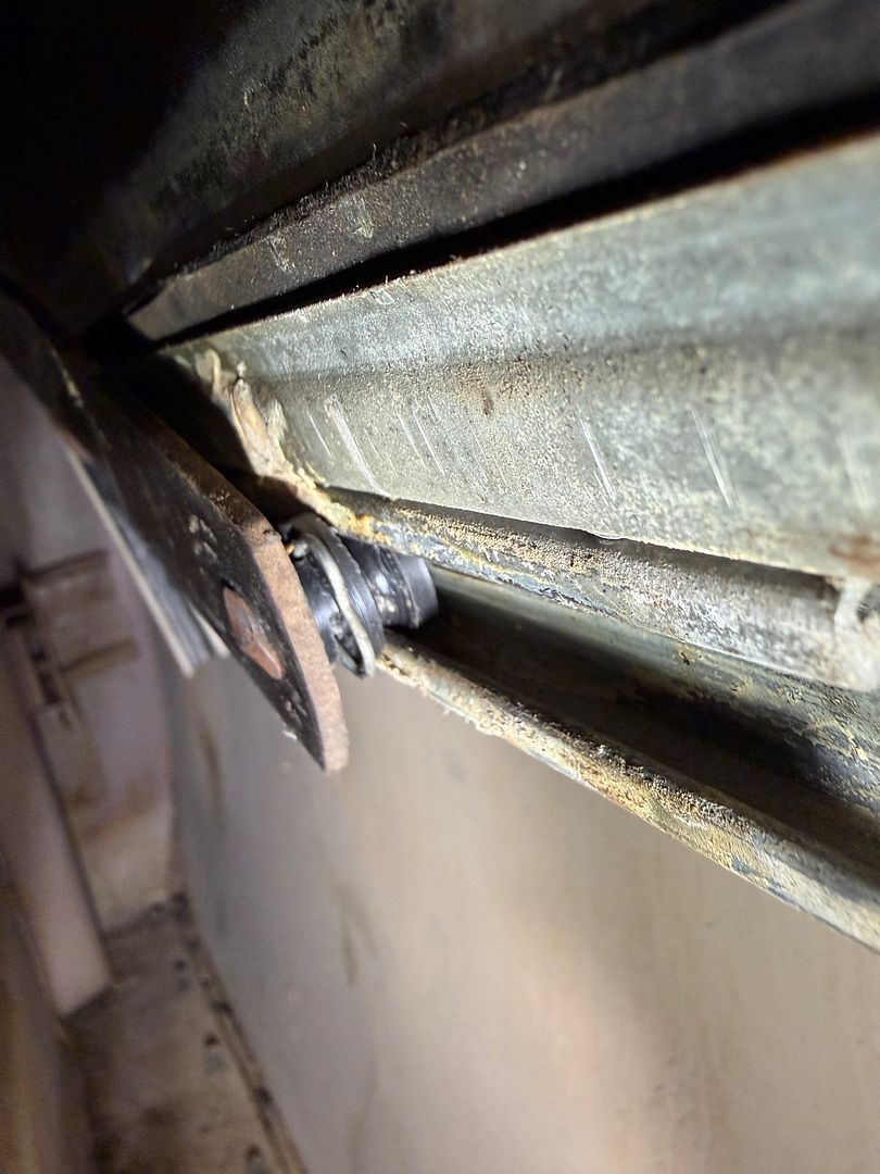

The reliefs for the spring clip was added using a hacksaw blade. Highly technical stuff right here.
Relief added for the window track....
All back in place, good as new. With some closing restraint, we may get another 60 years out of this one...

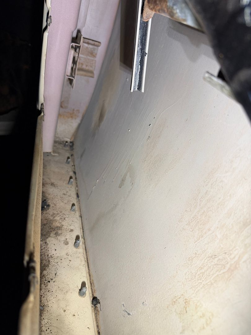

I believe this to be the first time this door has been opened, but look how nice and clean a rust-free truck door is inside...
