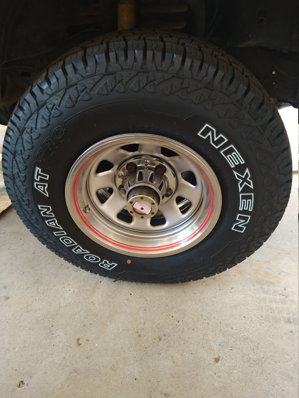

I found a nice set of 15x8 rims locally, and had new Nexen tires mounted! They look great, just missing a shiny set of lug nuts. First set I bought was 15x7 I was told 4x4 came with the 15X8 rims, the 31x10.5 should sit better on it. Also replaced the old sun faded Lariat badges. Next is repainting the rear bumper and fixing the rust on cab floor and a/c compressor.

Looks nice, good find.
