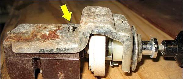

With all screws out of dash and radio loose, you should be able to tilt it forward and see the headlight switch directly behind where the headlight **** is. So with the shaft out then you tilt the plastic dash bezel forward to get your hand above the switch and feel for a metal button to press and hold to release the headlight shaft from the headlight switch. **** and shaft will slide out as one piece with the button held down.
