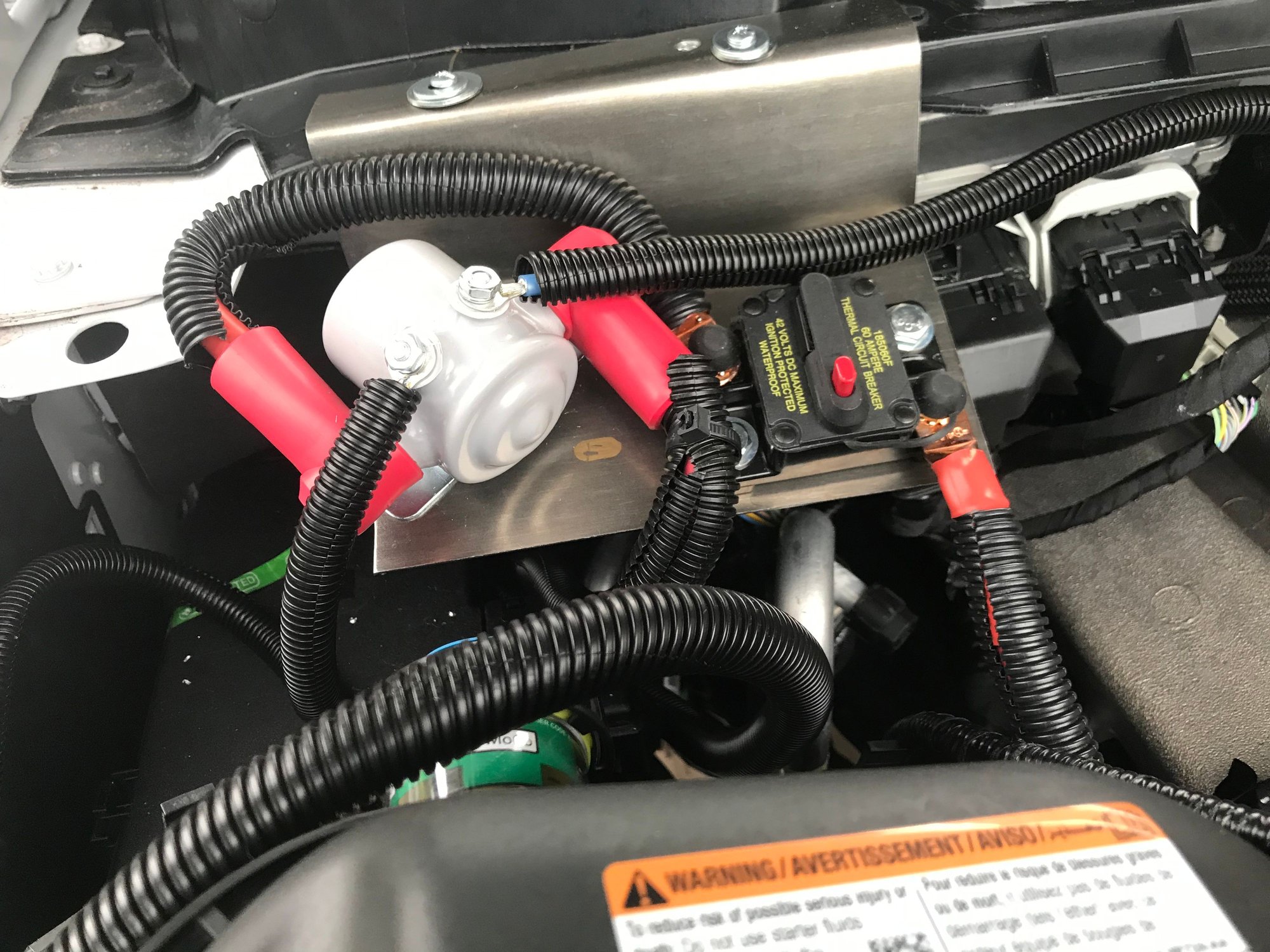

Originally Posted by skanj0
no problem. This is what I used. Quality item. Trombetta?s Bear DC Contactor, With 225 Amps Continuous Duty and 300 Amps Intermittent Duty Current Carrying Capability, Provides an Economical Solution to High Current Switching Applications
The biggest challenge you will have is finding a place to mount the breaker and contactor under the hood of the truck. I ended up mounting both on the front lower side of the firewall on the passenger side of the truck. Both are basically behind the inner fender liner (I have a 2016 F350). If you are lying on the ground behind the passenger side front tire, look up at the space between the firewall and the back side of the inner fender liner. Thats where I mounted both items. I can reach up with a 6” flat blade screw driver and trip or reset the breaker if needed. I coukd not find anywhere to mount both items from the top side of the engine compartment.
Ok, after some time, I'm finally starting to tackle this project. And, man oh man, are you right about not enough space.
Can you detail the procedure for mounting the circuit breaker and contactor where you describe above? For a complete idiot about this stuff for me please?
For example...
1. I'm assuming I have to remove the fender liners (it appears there are two). Is this just the self tapping screws that line the outside of it? Anything to be aware of in that R&R procedure?
2. How high up in there did you mount the two components? I'm concerned about water intrusion so I'm assuming you got them high? If not, have you had any trouble with water?
3. Did you have to jack the truck up to do it? Take the wheel off?
4. Anything else I should be aware of?
Old 01-13-2019, 03:40 PM
191124x7's Avatar
191124x7
191124x7 is offline
Join Date: Nov 2016
Location: FL
Posts: 668
Received 2 Likes on 2 Posts
Well, I did it!
I made a lot lot of mistakes. Too many to count.
Some of of my favorites were dropping a wrench on top of the fender liner after I got it back on...so it had to come back off again. Or that one time, “at band camp,” when I stuck the positive wire into the Anderson connector and it didn’t fit. But my all time favorite has to be when I over tightened the shelf and broke the head off the screw.
There were some moments where I almost threw up... like when I drilled two, 3/4 inch holes through the bed, and when I saw metal while drilling through plastic for the shelf. Oh yeah...damaging the high amp upfitter insulation (both) while cutting off the zip tie.
But boy oh boy do I have an AMAZING charging system.
The solenoid is wired to switch #1, and I now have 14.74 volts direct from the battery via #2 wire all the way back near the tailgate inside the bed!
Thanks to all who helped in this thread and a couple others, with special thanks to skanj0 for above and beyond details and patience.
